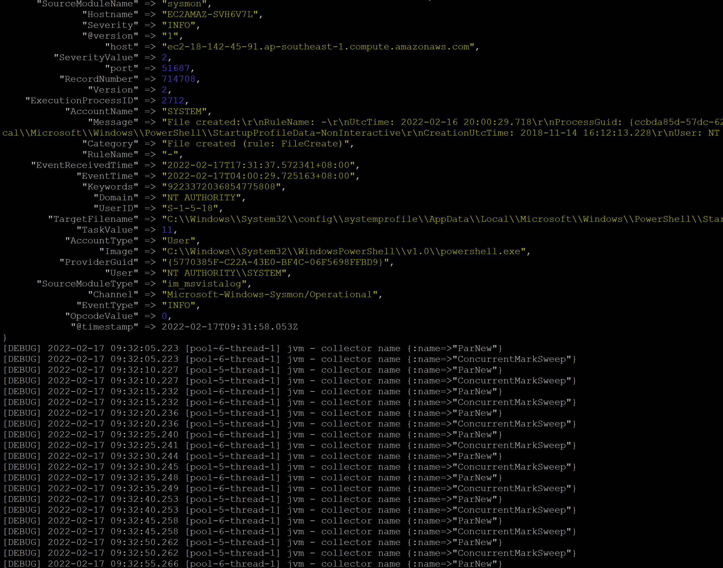

After several minutes, the debug log will have such output as below:
It will stop the log ingestion and keep giving out the repeated output:
[DEBUG] 2022-02-17 09:32:05.223 [pool-6-thread-1] jvm - collector name {:name=>"ParNew"}
[DEBUG] 2022-02-17 09:32:05.223 [pool-6-thread-1] jvm - collector name {:name=>"ConcurrentMarkSweep"}
[DEBUG] 2022-02-17 09:32:10.227 [pool-5-thread-1] jvm - collector name {:name=>"ParNew"}
[DEBUG] 2022-02-17 09:32:10.227 [pool-5-thread-1] jvm - collector name {:name=>"ConcurrentMarkSweep"}
[DEBUG] 2022-02-17 09:32:15.232 [pool-6-thread-1] jvm - collector name {:name=>"ParNew"}
[DEBUG] 2022-02-17 09:32:15.232 [pool-6-thread-1] jvm - collector name {:name=>"ConcurrentMarkSweep"}
[DEBUG] 2022-02-17 09:32:20.236 [pool-5-thread-1] jvm - collector name {:name=>"ParNew"}
[DEBUG] 2022-02-17 09:32:20.236 [pool-5-thread-1] jvm - collector name {:name=>"ConcurrentMarkSweep"}
[DEBUG] 2022-02-17 09:32:25.240 [pool-6-thread-1] jvm - collector name {:name=>"ParNew"}
[DEBUG] 2022-02-17 09:32:25.241 [pool-6-thread-1] jvm - collector name {:name=>"ConcurrentMarkSweep"}
[DEBUG] 2022-02-17 09:32:30.244 [pool-5-thread-1] jvm - collector name {:name=>"ParNew"}
[DEBUG] 2022-02-17 09:32:30.245 [pool-5-thread-1] jvm - collector name {:name=>"ConcurrentMarkSweep"}
[DEBUG] 2022-02-17 09:32:35.248 [pool-6-thread-1] jvm - collector name {:name=>"ParNew"}
[DEBUG] 2022-02-17 09:32:35.249 [pool-6-thread-1] jvm - collector name {:name=>"ConcurrentMarkSweep"}
[DEBUG] 2022-02-17 09:32:40.253 [pool-5-thread-1] jvm - collector name {:name=>"ParNew"}
[DEBUG] 2022-02-17 09:32:40.253 [pool-5-thread-1] jvm - collector name {:name=>"ConcurrentMarkSweep"}
[DEBUG] 2022-02-17 09:32:45.258 [pool-6-thread-1] jvm - collector name {:name=>"ParNew"}
[DEBUG] 2022-02-17 09:32:45.258 [pool-6-thread-1] jvm - collector name {:name=>"ConcurrentMarkSweep"}
[DEBUG] 2022-02-17 09:32:50.262 [pool-5-thread-1] jvm - collector name {:name=>"ParNew"}
[DEBUG] 2022-02-17 09:32:50.262 [pool-5-thread-1] jvm - collector name {:name=>"ConcurrentMarkSweep"}
[DEBUG] 2022-02-17 09:32:55.266 [pool-6-thread-1] jvm - collector name {:name=>"ParNew"}
[DEBUG] 2022-02-17 09:32:55.266 [pool-6-thread-1] jvm - collector name {:name=>"ConcurrentMarkSweep"}
