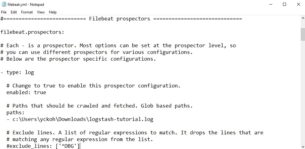

Hi, I've tried to send log lines from filebeat to Logstash as per the instructions in the reference. However, even though it shows that the pipeline has started successfully it seems to not give me any output on my command prompt upon logstash -f first-pipeline.conf --config.reload.automatic. What could be the reason? I have attached screens of the command prompt and filebeat.yml file. Any help is much appreciated!

Okay, so it looks like Filebeat isn't sending anything. Perhaps it has already reached the end of the input file? Can you look in its registry file to see the current position? Please paste the logs from when Filebeat starts up.
Hi Magnus, here is what I see from the registry file after setting the path to logstash-tutorial.log* (when it was previously set to logstash-tutorial.log the registry was always empty).
[{"source":"c:\Users\yckoh\Downloads\logstash-tutorial.log","offset":0,"timestamp":"2018-04-29T15:35:43.6028505+08:00","ttl":-1,"type":"log","FileStateOS":{"idxhi":7733248,"idxlo":817563,"vol":4058132}}]

The output.logstash: line in the Filebeat configuration is commented out, so the subsequent hosts line is connected to whatever comes before output.logstash:. Perhaps an output.elasticsearch: line?
Ah yes I missed that. Uncommenting the output.logstash line and commenting the output.elasticsearch line solved the problem. Thanks
