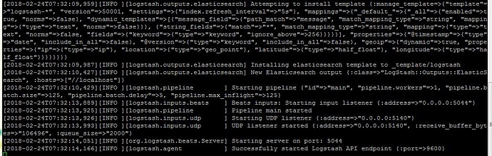

I look at the log:
tail -f logstash-plain.log success
