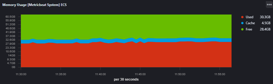

I checked my logstash heap,
this is my "htop" command on linux:
and this is my full cluster memory usage (the image is different from last screenshot because I just increased my memory by 32GB),
I want to ask about the heap on logstash, whats the different between logstash heap and memory usage on linux, because what I can see is the htop stats matched with the memory usage stats (thus are not normal) (because I set up -Xmx8g on the jvm.options, but the heap is normal(?) I guess,
hello, sorry for very late reply, after I learn further about jvm, I've come into conclusion that my logstash is receiving too much input, while the jvm couldn't clear the garbage fast enough resulting out of memory on the OS. The kernel will kill any process that took too many memory on the process that was logstash. I solved the issue by upgrade the memory and cpu, and tune the jvm too by using G1GC, I increased my jvm heap, increased the young generation size so the old generation is not too big while waiting for the GC to recover
