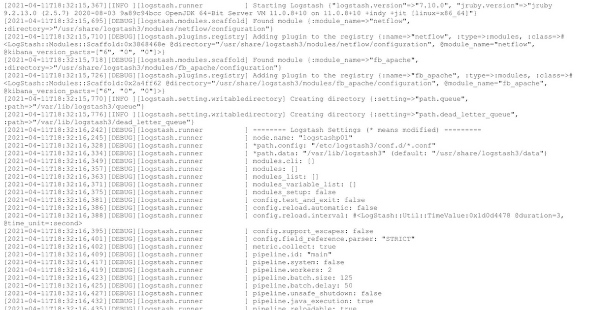

i deleted all logs and start logsash again with this conf file:
i added the logs output bellow,

logstash logs output after crashing:
Hi Kfir,
For logstash constantly stopping after start,
Based on the logs, it seems that this is your only pipeline, logstash will start and stop after it finishes it's job as nothing else require it to do.
Just to cross check, could you also share your pipeline.yml
Can you do a search on index "winlogbeat-2021.04.09-000453-copy" to see if "event.code 4625” successfully indexed into this index?
If no, can you do a GET search on Devtools with the same query?this is to check if there's any logs with event.code 4625 also to check if syntax of the query is correct.
Thanks Kavierkoo,
i had confused and i didn't see the events,
it works like a charm,
