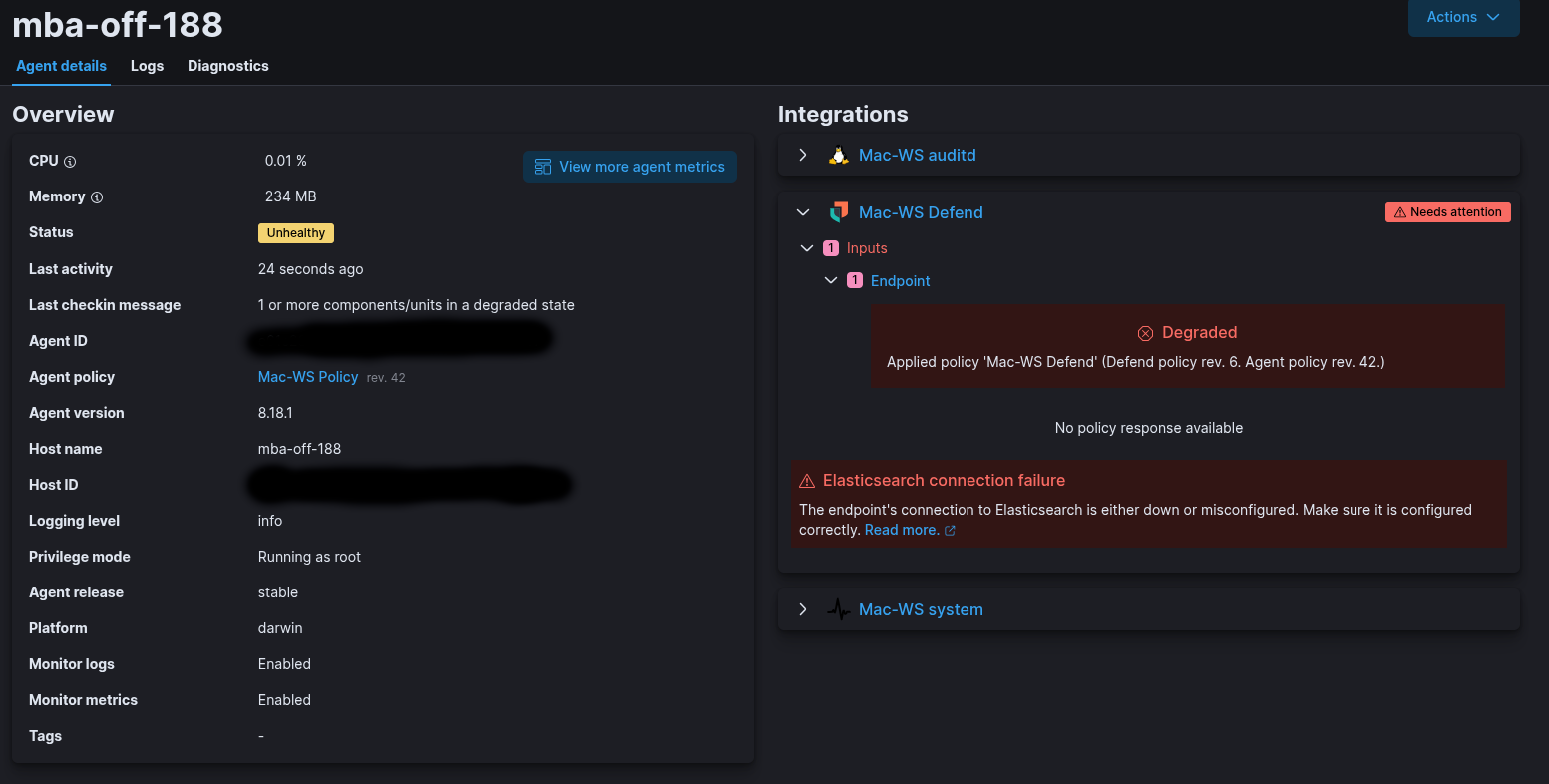

Hello everyone,
I have a problem with all my MacOS agents. As you can see below, the Agent itself was enrolled successfully and is sending logs, however, the Defend integration gives the error you see in the screenshot.
I have enabled all the permissions on the Macbooks; login items, full disk access, etc.
I have also tried to add the ca certificate to the Macbooks keychain but it didn't seem to solve anything (maybe I did it wrong?)
The agent and the whole elastic cluster is on version 8.18.1
The agent was installed with this command:
curl -L -O https://artifacts.elastic.co/downloads/beats/elastic-agent/elastic-agent-8.18.1-darwin-aarch64.tar.gz
tar xzvf elastic-agent-8.18.1-darwin-aarch64.tar.gz
cd elastic-agent-8.18.1-darwin-aarch64
sudo ./elastic-agent install --url=https://fleetserver:8220 --enrollment-token=<enrollment_token> --insecure
Thanks in advance for your help!
According to the error the problem is with output. I'd recommend using Endpoint self diagnostics test output, as described on
I ran the command sudo /Library/Elastic/Endpoint/elastic-endpoint test output and got the following output:

I tried restarting the ElasticEndpoint daemon and running the above command again but I get the same error.
could you try any other command, for example status or inspect ?
If there's only problem with retrieving the proxy configuration, then could you DM me or post publicly log from

2025-07-02 14:17:39: info: PolicyComms.cpp:1016     Process Events Index     : logs-endpoint.events.process-all
2025-07-02 14:17:39: info: PolicyComms.cpp:1023     Metadata Index           : metrics-endpoint.metadata-all
2025-07-02 14:17:39: info: PolicyComms.cpp:1024     Policy Index             : metrics-endpoint.policy-all
2025-07-02 14:17:39: info: PolicyComms.cpp:1025     Metrics Index            : metrics-endpoint.metrics-all
2025-07-02 14:17:39: info: PolicyComms.cpp:1026     Heartbeat Index          : .logs-endpoint.heartbeat-all
2025-07-02 14:17:39: info: PolicyComms.cpp:1031     Diagnostic Alert Rate    : [ 70 per-code, 10 per-rule, 100 total ] / 3600 seconds
Elasticsearch server: https://[elasticsearch_ipv6]:9200
With proxy: none
2025-07-02 14:17:39: debug: HttpLib.cpp:728 Making HTTP request to Elasticsearch without a proxy
2025-07-02 14:17:39: debug: HttpLib.cpp:900 Adding 160 CA certificates
2025-07-02 14:17:39: debug: HttpLib.cpp:939 Removing SNI from no connection? https://[elasticsearch_ipv6]:9200?pretty
2025-07-02 14:17:39: debug: HttpLib.cpp:1072 Establishing GET connection to [https://[elasticsearch_ipv6]:9200?pretty]
2025-07-02 14:17:39: error: MessageHelpers.cpp:313 CURL error: Could not resolve hostname [Could not resolve host: 2a0b:880:5:3801::252]
2025-07-02 14:17:39: info: Proxy.cpp:253 Proxy enumeration for test output
2025-07-02 14:17:39: info: Proxy.cpp:324 Reset proxy enumeration for test output
	Status: Could not resolve hostname [Could not resolve host: 2a0b:880:5:3801::252]
Elasticsearch server: https://elasticsearch_other_address:9200
With proxy: none
2025-07-02 14:17:39: debug: HttpLib.cpp:939 Removing SNI from no connection? https://elasticsearch_other_address:9200?pretty
2025-07-02 14:17:39: debug: HttpLib.cpp:1072 Establishing GET connection to [https://elasticsearch_other_address:9200?pretty]
2025-07-02 14:18:39: error: MessageHelpers.cpp:313 CURL error: Timeout was reached [Connection timed out after 60002 milliseconds]
2025-07-02 14:18:39: info: Proxy.cpp:253 Proxy enumeration for test output
2025-07-02 14:18:39: info: Proxy.cpp:324 Reset proxy enumeration for test output
	Status: Timeout was reached [Connection timed out after 60002 milliseconds]
Elasticsearch server: https://127.0.0.1:9200
With proxy: none
2025-07-02 14:18:39: debug: HttpLib.cpp:728 Making HTTP request to Elasticsearch without a proxy
2025-07-02 14:18:39: debug: HttpLib.cpp:900 Adding 160 CA certificates
2025-07-02 14:18:39: debug: HttpLib.cpp:939 Removing SNI from no connection? https://127.0.0.1:9200?pretty
2025-07-02 14:18:39: debug: HttpLib.cpp:1072 Establishing GET connection to [https://127.0.0.1:9200?pretty]
2025-07-02 14:18:39: error: MessageHelpers.cpp:313 CURL error: Could not connect to server [Failed to connect to 127.0.0.1 port 9200 after 0 ms: Could not connect to server]
	Status: Could not connect to server [Failed to connect to 127.0.0.1 port 9200 after 0 ms: Could not connect to server]
	Help: Make sure the server address is correct and that hosts can connect to it
2025-07-02 14:18:39: error: PolicyConfig.cpp:1410 Global configuration artifact is not available
2025-07-02 14:18:39: debug: PolicyTlsConfig.cpp:110 field (inputs[0].name) found in config
2025-07-02 14:18:39: debug: PolicyTlsConfig.cpp:110 field (inputs[0].id) found in config
2025-07-02 14:18:39: debug: PolicyTlsConfig.cpp:110 field (revision) found in config
2025-07-02 14:18:39: debug: PolicyTlsConfig.cpp:110 field (inputs[0].revision) found in config
2025-07-02 14:18:39: debug: PolicyTlsConfig.cpp:110 field (fleet.agent.id) found in config
2025-07-02 14:18:39: debug: PolicyTlsConfig.cpp:110 field (fleet.host.id) found in config
2025-07-02 14:18:39: debug: PolicyTlsConfig.cpp:100 field (inputs[0].policy.mac.advanced.allow_cloud_features) not found in config
2025-07-02 14:18:39: debug: PolicyTlsConfig.cpp:110 field (inputs[0].policy.global_telemetry_enabled) found in config
2025-07-02 14:18:39: debug: PolicyTlsConfig.cpp:100 field (inputs[0].policy.mac.advanced.set_extended_host_information) not found in config
2025-07-02 14:18:39: debug: PolicyTlsConfig.cpp:100 field (inputs[0].policy.mac.advanced.agent.connection_delay) not found in config
2025-07-02 14:18:39: debug: PolicyTlsConfig.cpp:100 field (fleet.protocol) not found in config
2025-07-02 14:18:39: debug: PolicyTlsConfig.cpp:100 field (fleet.path) not found in config
2025-07-02 14:18:39: debug: PolicyTlsConfig.cpp:110 field (fleet.hosts[0]) found in config
2025-07-02 14:18:39: debug: PolicyTlsConfig.cpp:110 field (fleet.hosts[1]) found in config
2025-07-02 14:18:39: debug: PolicyTlsConfig.cpp:110 field (fleet.access_api_key) found in config
2025-07-02 14:18:39: debug: PolicyTlsConfig.cpp:110 field (fleet.ssl.verification_mode) found in config
2025-07-02 14:18:39: warning: PolicyTlsConfig.cpp:56 TLS peer and hostname verification disabled
2025-07-02 14:18:39: debug: PolicyTlsConfig.cpp:100 field (fleet.ssl.ca_trusted_fingerprint) not found in config
2025-07-02 14:18:39: debug: PolicyTlsConfig.cpp:100 field (fleet.ssl.key) not found in config

Also, I have a linux laptop on the same network as this macbooks and everything works fine so probably not a network/firewall problem.

The output and fleet URLs looks bad, and the output provides a meaningful hint. If you believe these URLs should be valid (perhaps overriden host fiile?) try them if they resolve with other tools like nslookup https://elasticsearch_other_address:8220
You can verify the Endpoint config with inspect command. Further you can verify the aggregated config at Agent side Elastic Agent command reference | Fleet and Elastic Agent Guide [8.18] | Elastic
In good working situation both configs should be in sync, as the role of Elastic Agent is to forward Elastic Endpoint specific portion to the Endpoint service. However it's possible to see them off sync, when the communication between Agent and Endpoint is broken, or when the Agent config file is broken, etc. In such situation we need to look at the logs from both services in the diagnostic package gathered by diagnostics Agent command.
Regarding the IO error. If you run elastic-endpoint help command, or check the web reference, you'll see that the additional logging options can be applied to any command. If you experience the IO error very often then it should be possible to capture the logs from an IO error case, whether it's test output or status command.
I don´t see what that has to do with it since, like I said, my other machines in the same network that have the same config have no problem. It's only the macos machines that have this problem. I have this problem on all macos machines, all the linux servers and laptops don't have the issue.
Can you paste then the console output from elastic-endpoint test output from some linux and windows machine?
Are you sure you've got the same policy?
Was the log you posted above redacted, but the real one was having all URLs valid? Are they resolve to IPv4 or IPv6?

Gocha, so I jumped to wrong conclusion in my first response.
However, my recommendation stays the same, please use other tools to lear more why the URLs are not accessible on macOS.
For example, Elastic search replies with status message when hit by HTTP GET request:
curl https://[elasticsearch_ipv6]:9200
append -v to learn more in case of a failure
curl -v https://[elasticsearch_ipv6]:9200
If you get the Elasticsearch response, but elastic-endpoint test output keeps saying "Could not resolve host" let me know, I'll send you a DM with a link to upload more diagnostics.
No worries :slight_smile:
I test the curl commands on both the linux laptop and macbook and got two different results.
On the linux it was able to make the connection but says "missing authentication for REST request ..." which seems normal to me.
On the macbook however, it wasn't able to make the connection at all and gave me the following error:
curl: (56) CONNECT tunnel failed, response 403
It looks like you've got issues with your macOS configuration (or maybe even your network infrastructure). Since you confirmed that the address is not reachable by using other tools Endpoint diagnostics won't bring anything new here.
As I suggested in the beginning, I'd start with checking if the URLs resolve to correct IPs. Next I'd look at verbose output from curl -v https://[elasticsearch_ipv6]:9200, or openssl tools openssl s_client -connect https://[elasticsearch_ipv6]:9200
I will look into it.. Thanks for the help so far!
