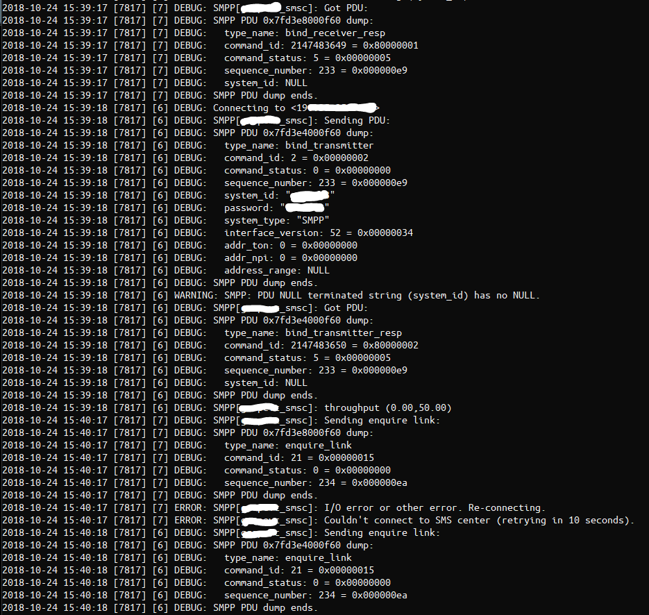

Can the Multiline filter plugin handle a log file that has multi-line events occurring concurrently and interweavingly ?
Explanation
I have a complex query about multi-line logs that are interwoven with other multi-line logs. Here is a snippet of what this looks like. Note: In the below snippet, Thread 6 and Thread 7 are running simultaneously
Each time an event occurs, it is logged from start to finish over multiple log lines. However, other events can be happening simultaneously on a different thread. Therefore, the logs get mixed together. Can the Aggregate filter plugin handle interwoven logs of this type? Any feedback will be greatly appreciated.
THANK YOU!
