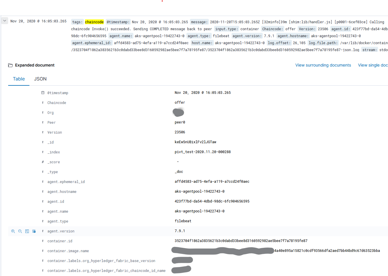

So I'm after the sub-set of logs in /var/lib/docker/containers/*/*.log whose container name starts with ' dev-', but kibana is not showing me any docker metadata for those containers' logs. When I remove the drop_event part, the logs are coming through (along with many I don't want), but the ones I do want are missing the container metadata, as can be seen here:
The weird thing is that all other container logs (of containers whose names do not start with ' dev-') ARE showing docker metadata in kibana.
Next to this setup, on the same cluster, I'm running another instance of filebeat which uses the same input definitions and sending them to elastic-cloud (so not eck for this one) and those DO show the container metadata corectly for the logs I'm after:
