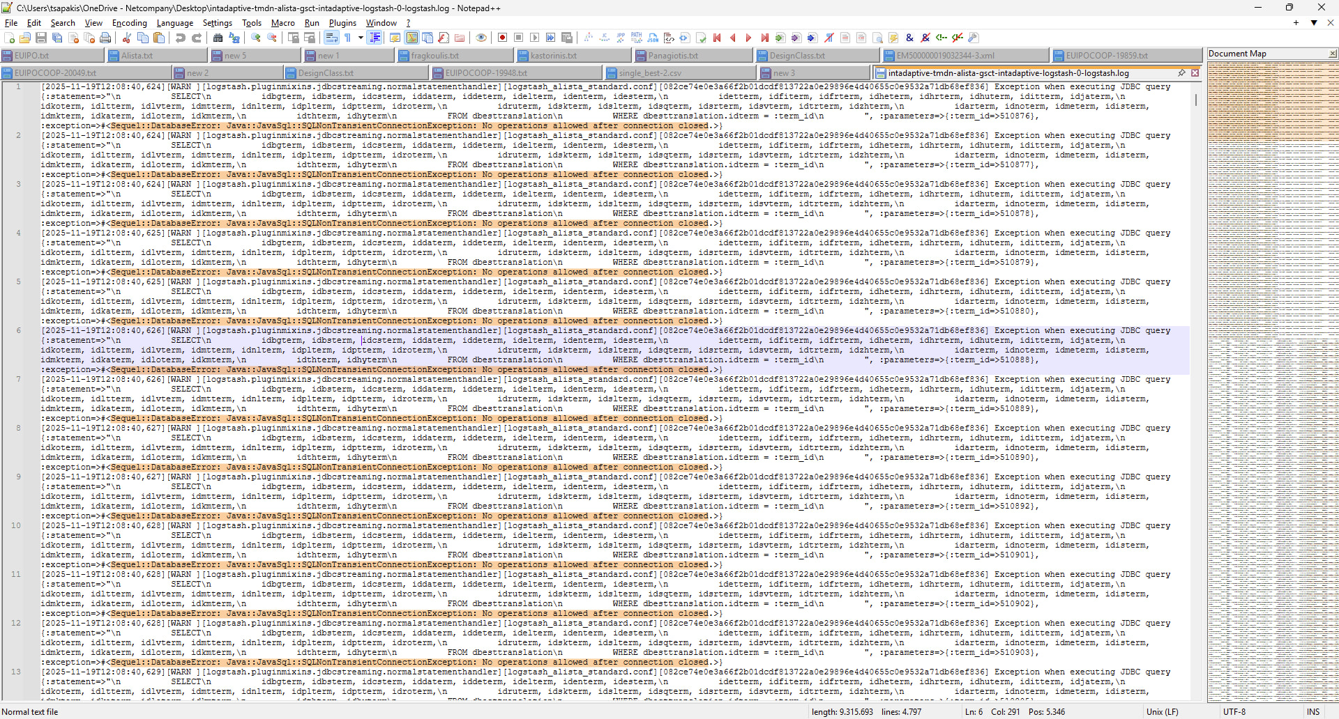

We are facing a critical issue with our Logstash indexing pipeline during the filtering phase, which executes some very heavy queries on our application DB.
Our business application is executing constant write operations on the DB and is triggering a Solr server to index constantly. This goes on for several hours.
The issue occurs when the Logstash pipeline kicks in while that process is active, and its filtering queries try to connect to the DB too.
We immediately see numerous WARN messages containing errors like: "Sequel::DatabaseError: Java::JavaSql::SQLNonTransientConnectionException: No operations allowed after connection closed.":
The problem is only resolved by restarting Logstash, otherwise it keeps throwing those errors forever. Once restarted, it seems to operate smoothly.
Can you please think of a reason for this phenomenon and possibly a solution? We have tried with increasing timeouts, introducing paging, downgrading the JDBC driver, but nothing has helped.
