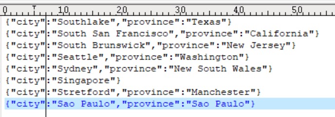

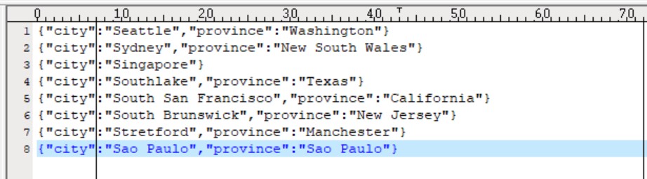

Number of docs count does not match number of json file records
Hi. I am trying to load a json file with 8 records from filebeats to logstash (latest verion 7.13). It looks like i have no errors but when i check number of records at Kibana Index Management i see docs counts = 1 (also i checked at Discover and there is indeed just one document/event).
json file

So, i was expecting to see 8 doc counts instead of just 1. Any idea what could be wrong.

At logstash log i can see 7 records instead of the original 8:
{"log":{"offset":44,"file":{"path":"/home/dashboards/ingest_data/cities3.json"}},"ecs":{"version":"1.8.0"},"city":"Sydney","province":"New South Wales","input":{"type":"log"},"@timestamp":"2021-06-13T14:08:17.814Z","host":{"name":"mvdElastick1.company.com"},"@version":"1","agent":{"type":"filebeat","version":"7.13.1","ephemeral_id":"861f8e4f-9d78-47d6-9b1f-b5ac7bb46e24","name":"mvdElastick1.company.com","hostname":"mvdElastick1.company.com","id":"54d7d3c2-2b0e-4e0f-a27d-d6c79d4db85c"}}
{"agent":{"type":"filebeat","version":"7.13.1","ephemeral_id":"861f8e4f-9d78-47d6-9b1f-b5ac7bb46e24","name":"mvdElastick1.company.com","hostname":"mvdElastick1.company.com","id":"54d7d3c2-2b0e-4e0f-a27d-d6c79d4db85c"},"ecs":{"version":"1.8.0"},"city":"South Brunswick","province":"New Jersey","input":{"type":"log"},"@timestamp":"2021-06-13T14:08:17.814Z","host":{"name":"mvdElastick1.company.com"},"log":{"offset":211,"file":{"path":"/home/dashboards/ingest_data/cities3.json"}},"@version":"1"}
{"agent":{"type":"filebeat","version":"7.13.1","ephemeral_id":"861f8e4f-9d78-47d6-9b1f-b5ac7bb46e24","name":"mvdElastick1.company.com","hostname":"mvdElastick1.company.com","id":"54d7d3c2-2b0e-4e0f-a27d-d6c79d4db85c"},"ecs":{"version":"1.8.0"},"city":"Southlake","province":"Texas","input":{"type":"log"},"@timestamp":"2021-06-13T14:08:17.814Z","host":{"name":"mvdElastick1.company.com"},"@version":"1","log":{"offset":114,"file":{"path":"/home/dashboards/ingest_data/cities3.json"}}}
{"agent":{"type":"filebeat","version":"7.13.1","ephemeral_id":"861f8e4f-9d78-47d6-9b1f-b5ac7bb46e24","name":"mvdElastick1.company.com","hostname":"mvdElastick1.company.com","id":"54d7d3c2-2b0e-4e0f-a27d-d6c79d4db85c"},"ecs":{"version":"1.8.0"},"city":"Singapore","input":{"type":"log"},"@timestamp":"2021-06-13T14:08:17.814Z","host":{"name":"mvdElastick1.company.com"},"@version":"1","log":{"offset":92,"file":{"path":"/home/dashboards/ingest_data/cities3.json"}}}
{"log":{"offset":155,"file":{"path":"/home/dashboards/ingest_data/cities3.json"}},"ecs":{"version":"1.8.0"},"city":"South San Francisco","province":"California","input":{"type":"log"},"@timestamp":"2021-06-13T14:08:17.814Z","host":{"name":"mvdElastick1.company.com"},"@version":"1","agent":{"type":"filebeat","version":"7.13.1","ephemeral_id":"861f8e4f-9d78-47d6-9b1f-b5ac7bb46e24","name":"mvdElastick1.company.com","hostname":"mvdElastick1.company.com","id":"54d7d3c2-2b0e-4e0f-a27d-d6c79d4db85c"}}
{"log":{"offset":0,"file":{"path":"/home/dashboards/ingest_data/cities3.json"}},"ecs":{"version":"1.8.0"},"city":"Seattle","province":"Washington","input":{"type":"log"},"@timestamp":"2021-06-13T14:08:17.814Z","host":{"name":"mvdElastick1.company.com"},"@version":"1","agent":{"type":"filebeat","version":"7.13.1","ephemeral_id":"861f8e4f-9d78-47d6-9b1f-b5ac7bb46e24","name":"mvdElastick1.company.com","hostname":"mvdElastick1.company.com","id":"54d7d3c2-2b0e-4e0f-a27d-d6c79d4db85c"}}
{"agent":{"type":"filebeat","version":"7.13.1","ephemeral_id":"861f8e4f-9d78-47d6-9b1f-b5ac7bb46e24","name":"mvdElastick1.company.com","hostname":"mvdElastick1.company.com","id":"54d7d3c2-2b0e-4e0f-a27d-d6c79d4db85c"},"ecs":{"version":"1.8.0"},"city":"Stretford","province":"Manchester","input":{"type":"log"},"@timestamp":"2021-06-13T14:08:17.814Z","host":{"name":"mvdElastick1.company.com"},"log":{"offset":263,"file":{"path":"/home/dashboards/ingest_data/cities3.json"}},"@version":"1"}
Still, i can see only one document at Kibana:
Appreciate any help.

So, logstash i saying /showing 7 out of 8, but at kibana i can see only 1 document:
This is the json file i have used:
I was checking some similar cases, and someone said that json records should have an index json record before each of my json records. Not sure if this could be the case.
I assume that my original assumptions, are ok, that after processing this json file i should see 8 documents inside the index, right ?
Thanks in advance.
Regards
@rafaell2 Can you post the actual text of the json please not a screen shot.
You are probably not getting the last line as it would require a newline, otherwise filebeat does not know the line is complete. I suspect the last line is the line that is missing.
Also try taking out this line In your logstash
      document_id => "%{[@metadata][document_id]}"
My Completes Solution

Hi Stephen !!! hate to say it BUT IT WORKED !!!
This line was causing the whole mess !!! Not sure from where i got this example, but i will need to go back to basis and figure out what is this for !!! But if i leave it i get just one document, but without it it works just fine !!!
Regarding the missing line, indeed was because the lack of a new line at the end of the file !!!
So, thanks a million to all of you who helped me out with this issue !!!
