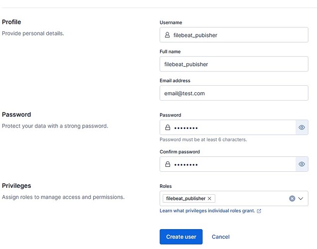

This is the role I created as per instructions from the documentation
And this is the user:
I can get around the problem by adding superuser to the Privileges:Roles like this:
But that defeats the purpose of creating a limited privileged user.
Can someone tell me what I did wrong?

Then I run
/usr/share/filebeat/bin/filebeat setup -c /etc/filebeat/filebeat.yml --path.data /var/lib/filebeat --path.home /usr/share/filebeat
I don’t get any errors from this command, just a bunch of success messages. Then i go into kibana, i see all the boiler template dashboards.
then i create the role and user as shown in my original message. Then I edit my filebeat.yml to look like this:
###################### Filebeat Configuration Example #########################
# This file is an example configuration file highlighting only the most common
# options. The filebeat.reference.yml file from the same directory contains all the
# supported options with more comments. You can use it as a reference.

In other words, i just comment out elastic user and bring in the filebeat_pubisher user. I made sure the password for filebeat_pubisher is ABCD1234.
I then go into modules.d directory and
cp system.yml.disabled system.yml
cp apache.yml.disabled apache.yml
And I edt the approprioate lines in system.yml and apache.yml from false to true to enable logging.
Then I go and do systemctl enable filebeat && systemctl start filebeat. Then my syslog shows the errors in the original message. Then i go to kibana and add the superuser role to the filebeat_pubisher user, and error goes away.
Did you run the setup using the setup role with the modules enabled or disabled? It is not clear.
I edit filebeat.yml to use elastic user. Then I run set up. Then i enable modules system.yml and apache.yml. Then i edit filebeat.yml to use filebeat_pubisher with just the filebeat_publisher role. Then i systemctl start filebeat. Then i get error. Then i add superuser to the filebeat_publisher role. Then I systemctl restart filebeat. Then error goes away.
You need to enable the modules before you run the setup for the setup to be able to load the required ingest pipelines for the modules that will be used.
Stop the filebeat service, enable the modules you want to use, run the setup with the setup role, after it finishes, change the filebeat user and see if it works.
OK thanks!
