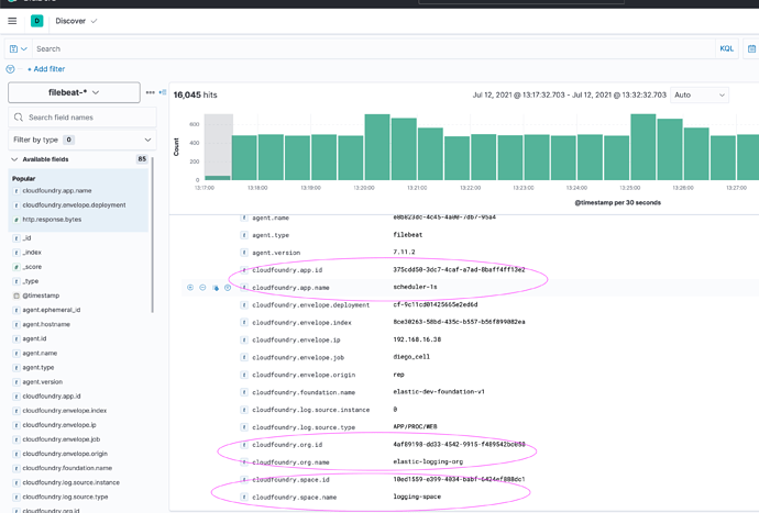

Here is what mine looks like with no processor
I renamed / restarted app
@pausebreathefly
