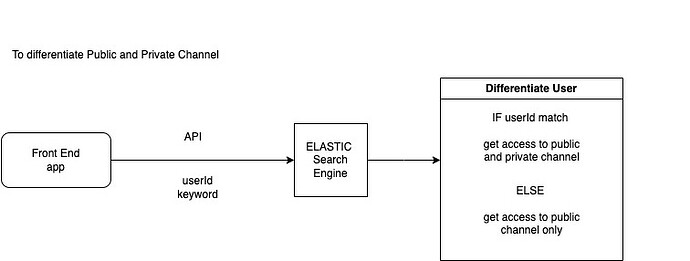

I do have question to ask on Searching where are we able to do private searching?
So from the picture, we have both private and public channel that we would like to do searching on.
The question right now is, can the application pass to elastic the userId for elastic to process the data and determine that this user can access to private channel and do searching for private post?
Thanks.

The question is, can our front end application pass the userid and keyword to do the searching to Elastic, for it to process, if the userId available in the data, then they able to access to the private Channel and do the searching for private post?

You found the right answer, Document Level Security is what you need here!
