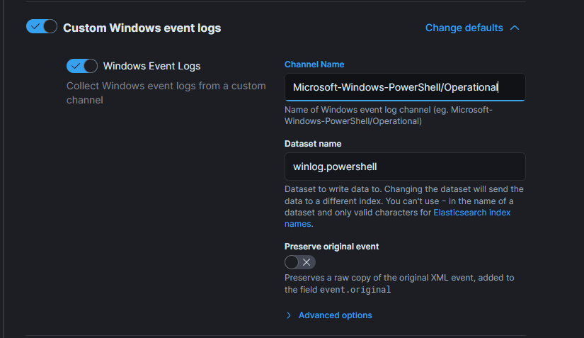

The operational logs of powershell seem to have the data I need
To grab this data into elastic I will need a custom windows log integration
Does not use the process.args field
