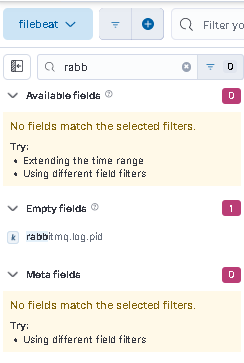

so i need to see this in kibana
rabbitmq.log.pid but i dont know how to configure
and this i can found
the logs is in /var/log/pods/ and i have the logs in this directory for rabbitmq
