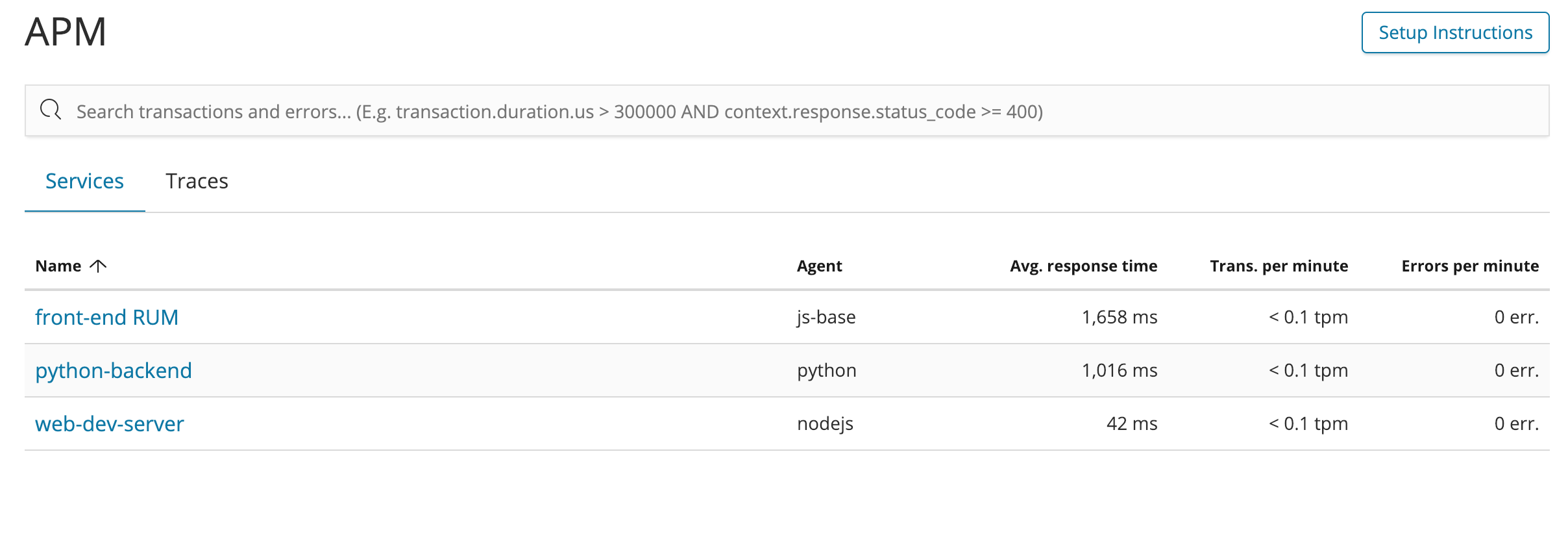

RUM timeline are not align with chrome network waterfall; And RUM not work with Distributed tracing
The same request, but observe different metric in elastic APM RUM and chrome develop tools
RUM
total duration is: 1861ms
and duration for exahgne.json, symbol.json, data.json are the same, 197ms
picture 1:
Chrome Dev Tools
total durating is 4.77s
the most cost request is fetching symbol.json, which cause 3.34s
Not work with Distributed tracing
I have three service
but from picture 1 above, there one service in the transaction. They are not share the same parent trace id

Thanks for answer, the problem is cause by distributedTracingOrigins, I didn't set this config options
By the way, If I have several service in backend behind a F5 device, how should I input the distributedTracingOrigins? put the F5 IP?
distributedTracingOrigins:['http://localhost:80','http://0.0.0.0:8080']
And I don't see the elastic-apm-traceparent header you mention above:
You should see the elastic-apm-traceparent header on the outgoing request to your own services (e.g. the request to GET /symbol.json), the request that is selected in your screenshot is to the APM server. I should have made that clear in my initial comment.
The important thing with configuring distributedTracingOrigins is to set the origin that is used to create the http request. On the RUM agent before each http request is send we check whether the origin of that request exists on the distributedTracingOrigins list, if so we will add the elastic-apm-traceparent header. In your case it seems that the requests are made to the F5 IP, therefore that should be added to distributedTracingOrigins. You can find more details on our distributed tracing guide

It is clear now, Thank you for the patient :grinning:
