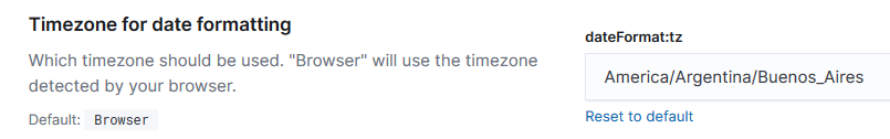

OK looking at your screenshots I think you may be in the EST time zone? Let's check further for timestamp issues. Can you do the following:
  1. check the system time and time zone on your endpoint
  2. check the same on the Packetbeat host
  3. Generate the DNS traffic again and note the system time on the host where you ran this.
  4. Search for the Packetbeat events again for this DNS traffic and gather the values of the following fields from one or more Packetbeat events:
     event.start
     event.end
     @timestamp
  5. Do the timestamps match the system time you noted in step 3?

I reviewed the Timezone for Date formatting:
And the DNS Internet Activity rule is not fired at all...
