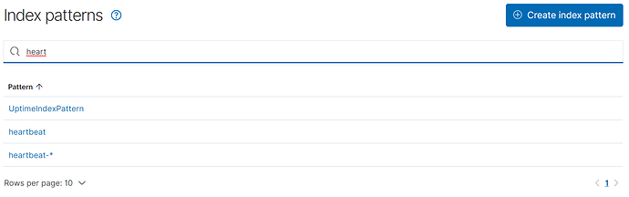

I seem unable to clone the uptime jobs? Datafeed is stopped and job is closed. Is this expected?
Other stopped / closed jobs are clonable. How is the relationship between Uptime and their ML jobs created? Could I manually create an ml job which is linked to an uptime monitor?

The most common reason for not being able to clone an ML job is that we cannot find a matching kibana index pattern.
Can you create an index pattern for heartbeat-* manually, i mentioned the method in another issue. Missing index pattern heartbeat-*
After that you should be able to clone it. Btw why you want to clone it? if job is stopped, you can delete it and recreate it from uptime UI again.
@shahzad31 I'm trying to finetune these uptime ml jobs a bit and giving them the correct prefix in the meantime. Also I might try to script creation of the Uptime ML jobs. I can clone other (non-uptime- jobs without an issue. I definitely have a heartbeat-* index pattern, so that shouldn't be the issue.

@willemdh i think i figured out a reason why you can't clone uptime jobs, you need to create a more specific index pattern for heartbeat. Like it should be heartbeat-7* instead of heartbeat-*
let me know if that helps, also check this jsfilled https://jsfiddle.net/zx7ogybp/
