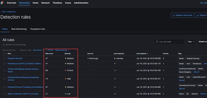

Is it possible to sort detection rules by risk score or severity?
I would like to only enable rules above a certain severity/risk score. What is the best way to do this?

Second this question/suggestion (though there doesn't seem to be an in-built feature at the moment)!
We have had some downstream dependencies that we have been waiting for before we could get to this work as outlined here:
opened 10:03PM - 11 Nov 19 UTC
NeededFor:SIEM
Team: SecuritySolution
Team:SIEM
Theme: rac
dependencies
This is meta ticket around ad-hoc requirements and feature requests from the det… ection engine underneath SIEM back to the alerting/actions plugins.
Top asks from our side along with use cases, possible solutions, and workarounds. These are ordered in our best guess of priority ranking in which we would like to have them.
Update 3/30/21, Frank Hassanabad: Updated to drop things lower in priority that have been fixed and push up the more higher priority items. Any questions about this ticket please consult with @spong or @peluja1012 as they are more in tune with the recent needs of detection engine.
## Make rules sortable, filterable, and aggregatable
Issue:
https://github.com/elastic/kibana/issues/50213
Use Case:
As a rule user, I need to sort, filter, and sometimes aggregate on rule types. For example, I need to sort my rule types on severity, or I need to filter them by severity.
Technical solution:
The current alerting/actions does not allow mapping down to the level of alerting/actions parameters. Therefore we cannot use the saved objects API of kql mixed with "order by". If that were changed and we were allowed mapping abilities to the alerting/actions parameters that would solve this. Either that or a plain API (even if slower like a table scan) to abstract us away so we can natively to the actions/alerting objects would make it to where we don't have write our own hand rolled solutions.
Current workaround:
Nothing written, but we should be able to use the KQL order by and tags once that is checked in to part of the way. However, for alerting/actions params storage we cannot easily sort/filter on those without using a table scan type technique where we do a "find" on a page of results and go through each and every one.

But I think more of those are fixed now, and we are going to relook at what it will take to either bubble this up or see what the hold up is.
Thanks for bringing it up.
