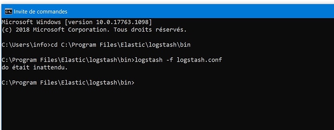

What is the complete error message?
Hello, I made the modification, I still have this message.
"do était inattendu"

I don't think the error is anything to do with your configuration. I think it is a more fundamental problem with running logstash.
OK,
Thanks a lot for your help.
What test can I do?

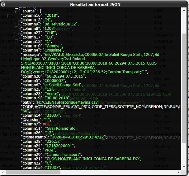

Hello,
it's almost ok !!!
In the first line was not priced as a definition of the fields.
Here is an example of a recording.
thank you in advance
