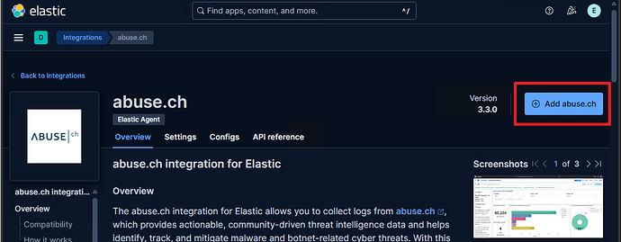

I have read the documentation on installing filebeat and enabling the threat intel modules. I thought I have enabled them correctly, but I do not see any dashboards downloaded to confirm they are installed (or configured correctly).
I also noticed that if I go to the integrations page the modules appear to be there as well.
So I am confused on if I need to go through all the command line and yml configuration changes manually or can I just click on the “Add (ex. Add abuse.ch, Add AlienVault OTX, Add Anomali, etc.) button from the integrations section and this will make all the confiuration changes needed? or is this integrations “add” button just to download the dashboards? or am I just more confused about this whole thing than I really know about?
Thanks for any help or explanation.
Hello @mouse51180
The page in the screenshot is used to install integrations used by Elastic Agents.
Since you are using Filebeat, you don’t need to add it.
However, you can leverage the assets installed by this integration. You can go to settings tab and click on Install abuse.ch.
It should install some assets including dashboards that can be used with the data ingested by Filebeat.
FYI: I’d recommend using elastic-agent. If you do not have a Fleet server, you can use it in standalone mode, which is similar to Filebeat.
