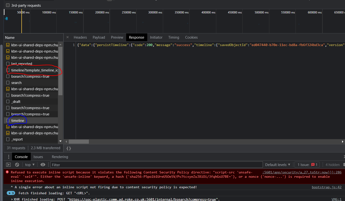

If I click the timeline button on an alert which uses this timeline template with the Google Chrome Dev window running I see the following :
  • I can see a request in the HTTP headers for the timeline template reporting a template ID of 2829c772-fe8e-470c-bac4-7b960ac797a1. This matches the ID of the timeline I have created so this looks good. Request URL is https://soc-elastic.comm.ad.roke.co.uk:5601/api/timeline?template_timeline_id=2829c772-fe8e-470c-bac4-7b960ac797a1
  • The response also looks sensible, shows HTTP 200 OK and the response includes the correct fields (I have cut some off this response as it was long but you can see the Bytes sent column being referenced at the end of this code); {"data":{"getOneTimeline":{"savedObjectId":"c548bf70-b654-11ec-8a31-7ba9a7f2f52c","version":"WzE5MjE4NSwyXQ==","columns":[{"columnHeaderType":"not-filtered","id":"@timestamp","type":"number"},{"columnHeaderType":"not-filtered","id":"event.action"},{"aggregatable":true,"description":"Short name or login of the user.","columnHeaderType":"not-filtered","id":"source.user.name","category":"source","type":"string","example":"a.einstein"},{"columnHeaderType":"not-filtered","id":"source.ip"},{"aggregatable":true,"description":"Bytes sent from the source to the destination."...
The preview field also confirms the fields in the response so up to this stage, all seems to work perfectly.
Looking at the screenshot below, all of the above data taken from the data at the request circled in red. Going down to the request circled in blue and the fields are back to the wrong ones. Presumably this is the request that is actually presented to me.
I don't know if this helps but hopefully it does. If I can gather any more data or logs please let me know

So I had a chance to chat with some of the Timeline/Template folks today and have a bit more information.
So first off, with regards to the extra requests you were seeing when using the Investigate in Timeline action, those are all okay/expected, and correspond to the creation of a new timeline from the Template provided when using the Investigate action. Basically it's fetching the template, then creating a new timeline from said template, so since you're seeing the new timeline not have the new fields we can suspect the bug is somewhere between the template being read and creating this new timeline. Here's the requests annotated:
(it was about here I found the exact spot of the issue :slight_smile: )
