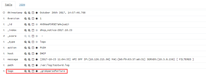

here is a example input:
In console, it can be parsed correctly:
but to elasticsearch, in kibana, I see:
why two different result? Thanks.
Well I thought maybe ISO8601 not compatible with my date format, so I changed it to DATA, but still no use...
Hi @imqishi,
did you try the grok debugger? there you can test if the pattern works for your timestamp also your grok pattern.
Grok debugger
Also the event in logstash and the event in Kibana are not the same :confused:
Cheers,
Dirk
Oh...I lost a pattern for these logs so some logs timestamp became now ...really stupid....
Thanks a lot!
