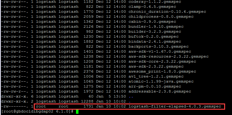

I did notice that the plugin gemspec file was installed as 'root' whereas everything else within /usr/share/logstash/vendor/bundle/jruby/2.3.0/specifications was owned by 'logstash':
I had to chown/chmod this file to 'logstash' user and change the permissions:
[root@gbdocldibgdap02 6.1.0]# chown logstash:logstash /usr/share/logstash/vendor/bundle/jruby/2.3.0/specifications/logstash-filter-elapsed-4.0.3.gemspec

Hi All,
I've managed to resolve this issue by amending the user:group ownership of various files and dirs to 'logstash:logstash'. For info, I rah the following:
chown -R logstash:logstash /data/logstash
chown -R logstash:logstash /var/log/logstash
chown -R logstash:logstash /etc/logstash
chown -R logstash:logstash /usr/share/logstash
I suspect the above is a sledgehammer approach and I've probably changed the ownership of more files than I'd need to get around the problem - however, it has solved my issue.
