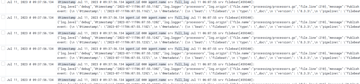

but not receive wazuh log just get filebeat log

You are receiving the Wazuh logs, the full_log field comes from Wazuh, you are just not parsing it, you will need to load the Wazuh ingest pipeline manually as well.
