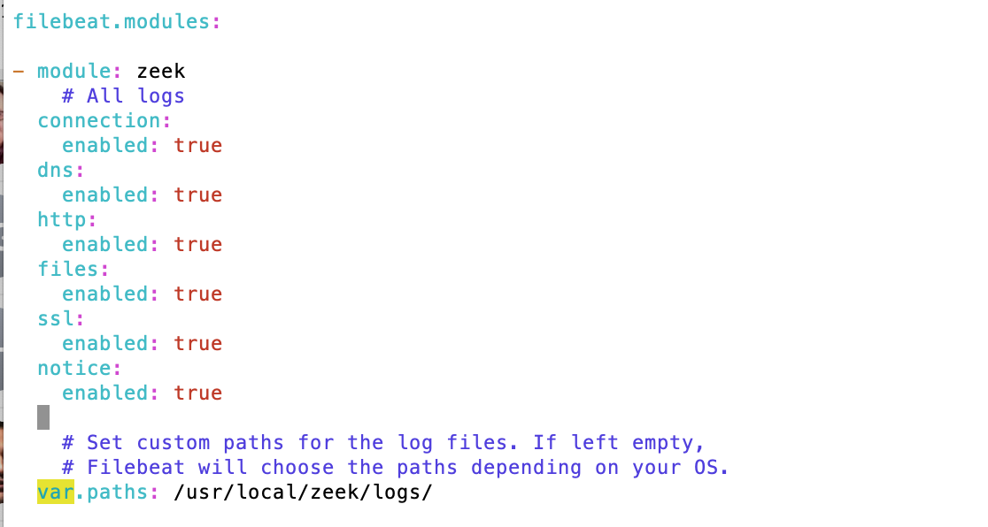

So ... I assume at this stage that this is where the "var.paths" option in the Filebeat Zeek module would be put into action .... so I modify the variable as shown in the attached:
However, when I try and fire up Filebeat with this variable change in place Filebeat bombs right away and I get the attached error:

NOTE3: (Added 28-JUL-2019) Oh boy ... what a difference an indent makes :slight_smile: I feel a tad silly however the previous "Fileset zeek/var is configured but doesn't exist" error was caused by me not properly indenting the var.paths variable in the filebeat.yml Zeek module. Oh well ... that issue solved ... so I have the Zeek logs being created in JSON format, I have the var.paths variable properly set now and I'm still getting the attached error when starting up.

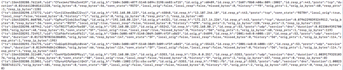

Also ... for informational sake here's a shot showing the path and contents of the Zeek Logs "current" directory and snippet of the conn.log showing it's indeed in JSON format.

I think var.paths needs to be an array of paths:
connection:
    enabled: true
    var.paths: ["/var/log/bro/current/conn.log"]
http:
    enabled: true
    var.paths: ["/var/log/bro/current/http.log"]
That works for me. Hope this helps!

I think the big difference with your config file was wrapping the path names in [""] .... I don't think I did that ...
