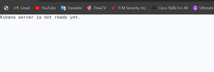

Yes service is running now.
but in status its indicating this type of error:
[ERROR][elasticsearch-service] Unable to retrieve version information from Elasticsearch nodes. getaddrinfo EAI_AGAIN darshan-elk-elmaster
Have you checked ES logs? Is ES reachable by curl?
port is opened dahsboard is able to able to open but
this type of message occuring.
Regards,
Darshan Rawal

Regards,
Darshan Rawal
HI Rios,
Yes, its reachable.
Regards,
Darshan Rawal
Is it reachable from the kibana machine?
Run the curl command you ran in your elasticsearch machine, but on your Kibana server:
curl -X GET -u elastic:8Qw3_B58rfrMaH+2QXj6 https://darshan-elk-elmaster:9200/ --cacert /path/to/the/ca/file.crt
The error you shared means that Kibana cannot connect to Elasticsearch, it is a network issue, getaddrinfo EAI_AGAIN means that your kibana host cannot resolve the domain you used to your Elasticsearch.
What is the result of ping darshan-elk-elmaster in your kibana server? If it cannot resolve the host, then it will not be able to connect to elasticsearch, then your Kibana will not work.
You need to fix the network issue first.
HI Leandro,
It's the result of above command i have runnined this command in elasticsearch machine:
  "name" : "darshan-elk-elmaster",
  "cluster_name" : "elk-cluster",
  "cluster_uuid" : "o6DPDkRXQMaYzqD2shwMFg",
  "version" : {
    "number" : "8.13.2",
    "build_flavor" : "default",
    "build_type" : "deb",
    "build_hash" : "16cc90cd2d08a3147ce02b07e50894bc060a4cbf",
    "build_date" : "2024-04-05T14:45:26.420424304Z",
    "build_snapshot" : false,
    "lucene_version" : "9.10.0",
    "minimum_wire_compatibility_version" : "7.17.0",
    "minimum_index_compatibility_version" : "7.0.0"
  "tagline" : "You Know, for Search"
and i'm not able to ping the darshan-elk-elmaster dns.
Regards,
Darshan Rawal
Is this from the result of the curl from kibana machine? You didn't share the host you run it.
Does telnet from kibana machine to your elasticsearch machine on port 9200 works? If this works then you shouln't have issues on Kibana log, so something is not right.
Please test the telnet from the Kibana machine to the elasticsearch machine on port 9200 and share the result.
root@darshan-elk-dashboard:/usr/share# curl -X GET -u elastic:8Qw3_B58rfrMaH+2QXj6 https://darshan-elk-elmaster:9200/ --cacert /etc/kibana/certs/elasticsearch/ca.crt
curl: (6) Could not resolve host: darshan-elk-elmaster
root@darshan-elk-dashboard:/usr/share# telnet 10.101.1.131 9200
Trying 10.101.1.131...
telnet: Unable to connect to remote host: No route to host
root@darshan-elk-dashboard:/usr/share# telnet darshan-elk-elmaster 9200
telnet: could not resolve darshan-elk-elmaster/9200: Temporary failure in name resolution
We are not able to figure it we have add the host entry also but still facing same issue.
We are able to ping on elasticsearch machine's ip from kibana. but not able to telnet .
if you want then i'll share config?
Regards,
Darshan Rawal

here is our both configuration please have look on it cluster health is also green.
Regards,
Darshan Rawal
You have a network issue.
Your Kibana server cannot connect to your Elasticsearch server, you need to solve this network issue for things to work, this is unrelated to Elastic tools.
Your kibana and elasticsearch configurations seems to be right, but it will not work until you fix the network issue.
ok once will figure it will update here,

Hello Leandro,
Thank you so much for your great help and for you prestigious time.
Connectivity is established now we are able to access dashboard.
