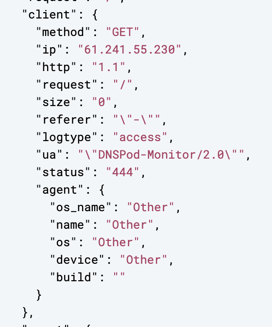

I used the period as a subfield delimite.
I checked oldest logs as JSON , you're right.client.agentis a field, is not a subfield.
截屏2021-05-23 11.20.54
Just like[client][agent] is the best solution.
