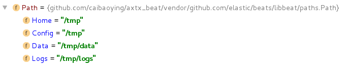

I created my own beats according to https://www.elastic.co/guide/en/beats/devguide/current/beater-interface.html#beater-interface
but when i run it, there was a error: Exiting: error initializing publisher: Error loading template /tmp/axtx_beat.template.json: open /tmp/axtx_beat.template.json: no such file or directory.
After debugging, I found before Unpack path is NULL, after Unpack the path settings are shown in the attachment
In fact, I want to modify the path in the attachment and change them to my own path, so what should I do?

This makes me wonder in which directory your IDE is building or running the executable. If you just build and run the beat, the default ${path} is set to the current working directory. Which in your case is /tmp. That is, your IDE sets the working directory to /tmp, not the beat.
To learn something about 'paths' check out this documentation (it's the same for all beats): https://www.elastic.co/guide/en/beats/filebeat/current/directory-layout.html
You can try to pass -path.home <path to dev directory> to the application arguments in your IDE. This should set all path variables to the correct path.
