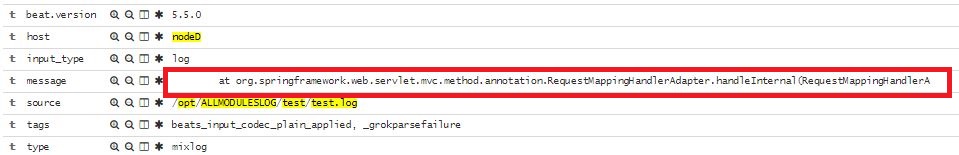

I'm trying to send Error stack to ELK server using filebeat installed in one of my server. Following is the sample log entry.
And following is the multiline.patter I have configured,
multiline.pattern: '^\d{4}-(0?[1-9]|1[0-2])-(0?[1-9]|[12][0-9]|3[01])'
multiline.negate: true
multiline.match: after
But when I do restart filebeat and see the result in Kibana, I can see the Error stack is separated for each line one-by-one as given below.
Question : How can I get all those Error stack in to a one single entry in Kibana ?

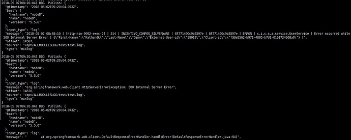

I tested your multiline config and it seems to work. Could you enable debug logging (./filebeat -e -d "*") to see what messages are published?
Here is the Debugging information :
"@timestamp": "2018-05-02T09:20:04.073Z", "beat": { "hostname": "nodeD", "name": "nodeD", "version": "5.5.0" }, "input_type": "log", "message": "2018-05-02 08:48:10 | [http-nio-9092-exec-2] | 514 | INCENTIVO_CONPOS_SILVERWARE | 8f771490c9a8597e | 8f771490c9a8597e | ERROR | c.i.c.s.a.service.UserService | Error occurred while updating user in silverware: 500 Internal Server Error | {\"First-Name\":\"Kalhandk\",\"Last-Name\":\"Dino\",\"External-User-id\":\"58919\",\"Client-id\":\"f33e5562-b971-4895-b7d1-0161724608a0\"} |", "offset": 14587, "source": "/opt/ALLMODULESLOG/test/test.log", "type": "mixlog" }
2018-05-02T09:20:04Z DBG Publish: { "@timestamp": "2018-05-02T09:20:04.073Z", "beat": { "hostname": "nodeD", "name": "nodeD", "version": "5.5.0" }, "input_type": "log", "message": "org.springframework.web.client.HttpServerErrorException: 500 Internal Server Error", "offset": 14670, "source": "/opt/ALLMODULESLOG/test/test.log", "type": "mixlog" }
2018-05-02T09:20:04Z DBG Publish: { "@timestamp": "2018-05-02T09:20:04.073Z", "beat": { "hostname": "nodeD", "name": "nodeD", "version": "5.5.0" }, "input_type": "log", "message": " at org.springframework.web.client.DefaultResponseErrorHandler.handleError(DefaultResponseErrorHandler.java:94)", "offset": 14789, "source": "/opt/ALLMODULESLOG/test/test.log", "type": "mixlog" }
2018-05-02T09:20:04Z DBG Publish: { "@timestamp": "2018-05-02T09:20:04.073Z", "beat": { "hostname": "nodeD", "name": "nodeD", "version": "5.5.0" }, "input_type": "log", "message": " at org.springframework.web.client.RestTemplate.handleResponse(RestTemplate.java:641)", "offset": 14882, "source": "/opt/ALLMODULESLOG/test/test.log", "type": "mixlog" }
