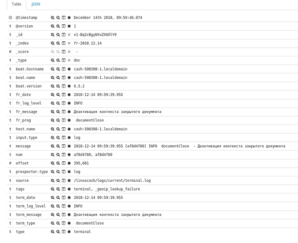

Hi everyone, can someone tell me why my log in the "terminal" type is in the index fr- * ?
Filebeat:
https://pastebin.com/zB1cefRe
Logstash conf files:
https://pastebin.com/BWUBVuLy
https://pastebin.com/hms3fMGz
Thank you in advance

I think if [type] == "frinit" or "frdriver" { should be if [type] in ["frinit", "frdriver"] { and that if "ERROR" or "WARN" in [fr_log_level] { should be changed to if [fr_log_level] in ["ERROR", "WARN"] {. Not sure that is the only issue, but would start by changing that.
Thanks, this solved my problem.
