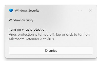

Is there sth we can do to prevent this Windows Defender popu when updating an Elastic Agent with Defend integration?
It’s just that it’s very confusing for end users. I’d like to keep

I’ll have to see if we can test, this might be an issue where for an upgrade, we leave AV registration enabled, and then when our process exits for the upgrade, Windows is throwing the popup until our upgraded process starts up and signals windows that it’s providing protection again.

Well, it’s complicated and I can’t really explain my situation here, but I’ve been seeing this since I started using Elastic Security Serverless every update (5+) of Elastic Agent on 2 different Windows 11 devices. I assumed this is a problem on any Windows.
Yes, that was what I was thinking. I’d really appreciate it if you could double check this.

Not sure when we’ll get to for sure, but I logged this for now: Potentially misleading toast notifications about AV protection on Windows · Issue #93 · elastic/endpoint · GitHub
In the mean time, this page includes registry and Group Policy settings you can use to suppress these notifications.
