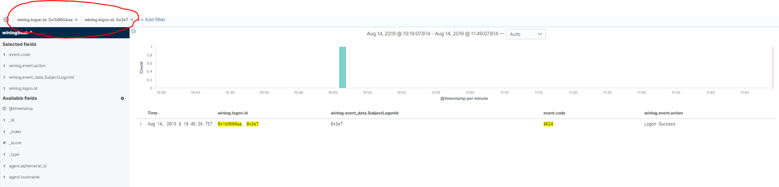

Hi @andrewkroh,
I've tested the function, and I get this
Events 4624 (Logon Success) has in winlog.logon.is a list with [TargetLogonId,SubjectLogonID] If I want to know which from those Logons are from privileged users, I filter from winlog.logon.id and both conditions are selected
but not direct correlation with the Administrator logon
(If I remove the second winlog.id filter then the admin logon appears, but you have to know which one to remove).
Personally I think is better to have direct correlation...
What do you think?
Thank you
Ana
That method of filtering (circled in red) is going to be very restrictive as it's effectively an AND query looking for events that have both values. I would expect users trying to search for any one logon ID to be able to search one field like winlog.logon.id: 0x3e7.
If you need to specifically search for a SubjectLogonId or TargetLogonId you can still do that directly too since we are retaining those fields.
What do you mean specifically? Like only copying a single logon ID to winlog.logon.id?
Hi Andrew,
Yes I know that is a restrictive and condition and it is automatically set when in a search (for example) you want to filter by that field. Then in the case of the list, both values are filtered... so you must know then which want to exclude later in order to have the proper information.
Yes, put only the value that has sense/meaning in the context of the event and use that value to correlate.
For example, I'm thinking in users working with a dashboard and filtering winlog.logon,id image in order to easily find all related activity to an specific logon, without having the knowledge what the SubjectLogonID or TargetLogonID means in that event.
In my opinion, that analysis (of determine which LogonID is relevant) is what the must do when parsing and converting the event into ECS.
Of course that for deeper investigation you can still search by SubjectLogonID and TargetLogonID
Does it makes sense?
Ana
