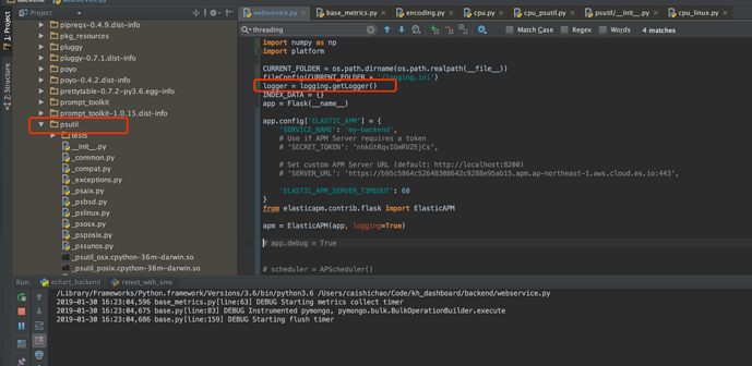

After I upgrade the agent from 4.0.3 to 4.1.0, I can't start the app which use APM python agent.

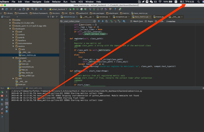

It is stuck after the log print:
base_metrics.py[line:63] DEBUG Starting metrics collect timer
seems it keeping on running in following function

I already installed psutil. I don't know what do you mean 'configured your logging setup', I have logger configuration

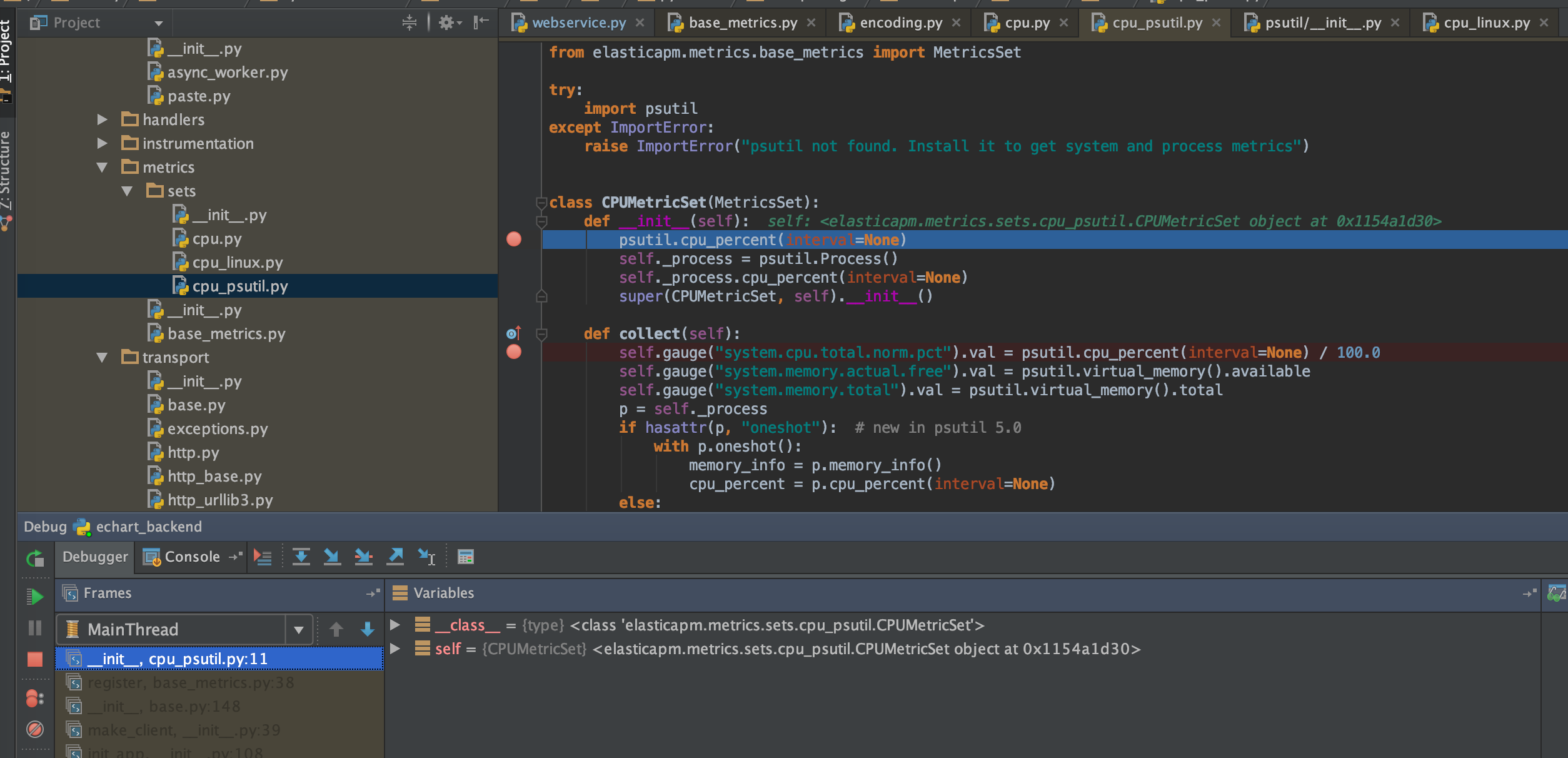

I trace the code in debug mode, it do find the psutil, it just keep on running in function def transform(value, stack=None, context=None):
