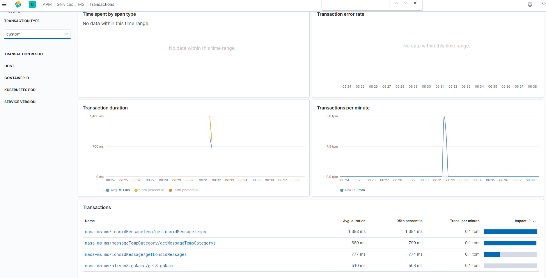

After using custom, the page load message does not appear.
But I want to use APM's performance monitoring capabilities.
My code is as follows, I don’t know how to modify it.

Hi @wajika ,
That does not seem to be correct, you can create any number of custom transactions along with the managed transactions(page-load, rout-change, etc.) created by the agent.
Can you enable the debug logs by setting logLevel: "debug" in the RUM configuration and post here?
Thanks,
Vignesh

pic 1
pic 2
pic 1 and pic 2 are increased apm.setInitialPageLoadName The results after.
however apm.setCustomContext And the data disappeared.

I have successfully made pageload and other events appear at the same time.
But the information of setCustomContext did not appear.
wajika
(wajika)
September 23, 2020, 10:42am
19
Some custom information is not displayed.
For example, the above getLogUsers request is not recorded
