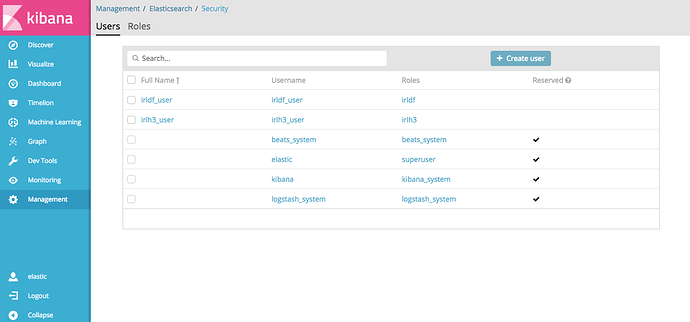

I guess what I meant to say is how do you know that the data in the irlh3_Offers visualization is actually reading only from the irlh3-campaign_stats data? I just recreated this exact scenario locally and this I see the expected results:

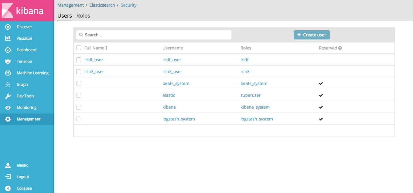

Two users (but I only gave them the irlh3/irldf roles)

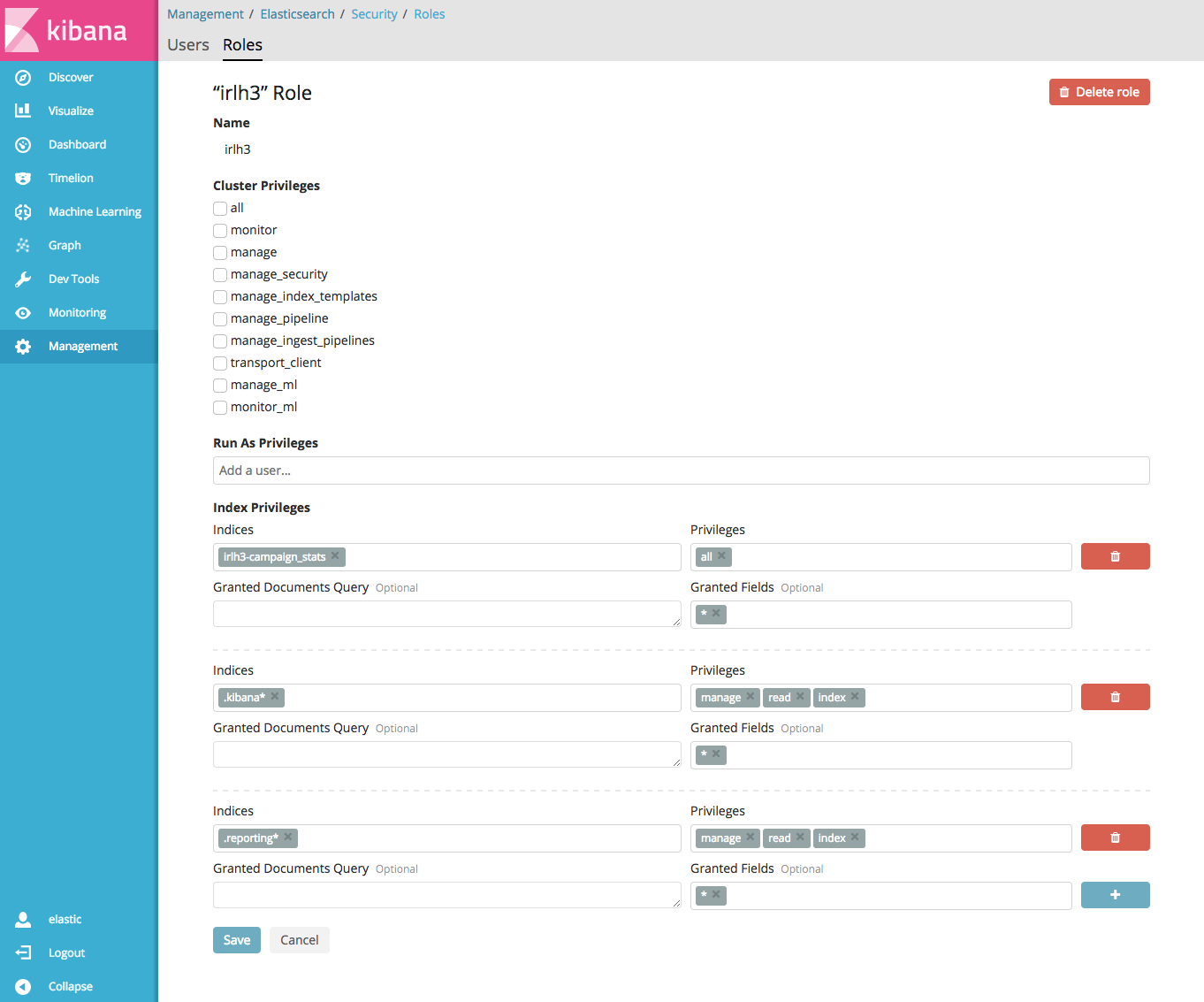

irldf role only has access to irldf-campaign_stats, kibana, and reporting:
Same for irlh3 role, but for irlh3-campaign_stats:

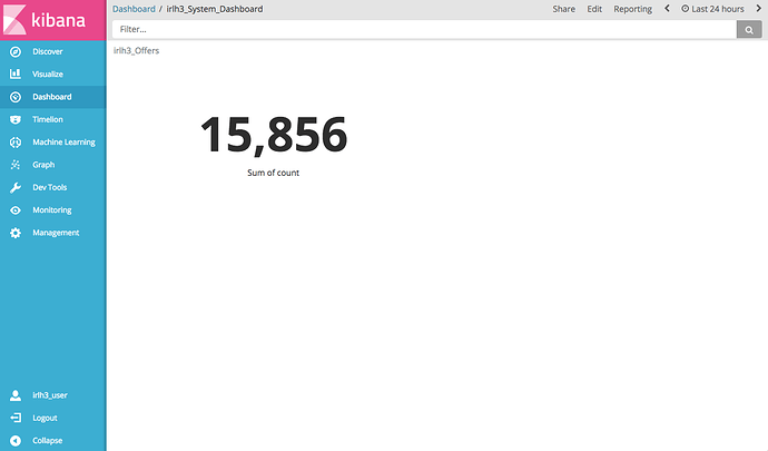

irlh3_System_Dashboard from the perspective of irlh3_user (last 24 hours):

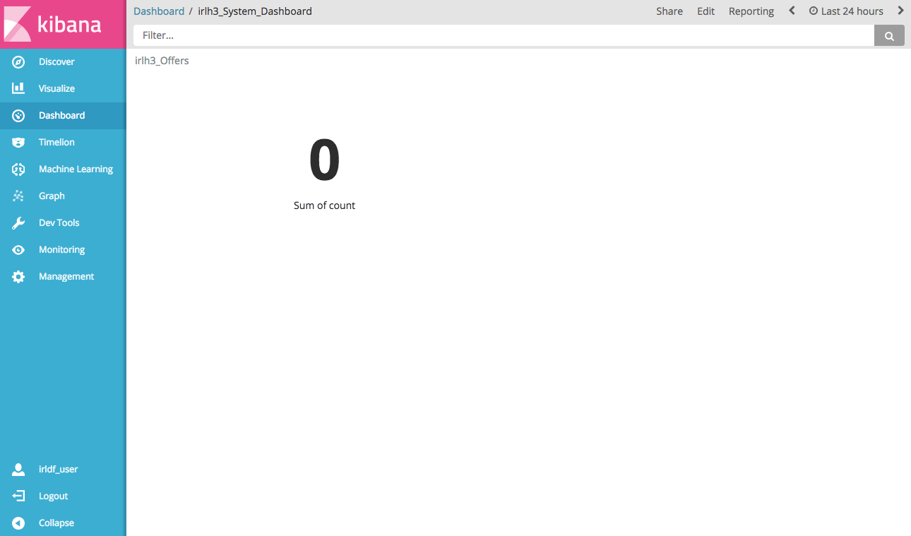

irlh3_System_Dashbaord from the perspective of irldf_user (last 24 hours):
Because of this I assume you've mapped something incorrectly (which I did several times while trying to prepare these screenshots). Can you try to take a list of screenshots like this so I can help verify that everything lines up?
