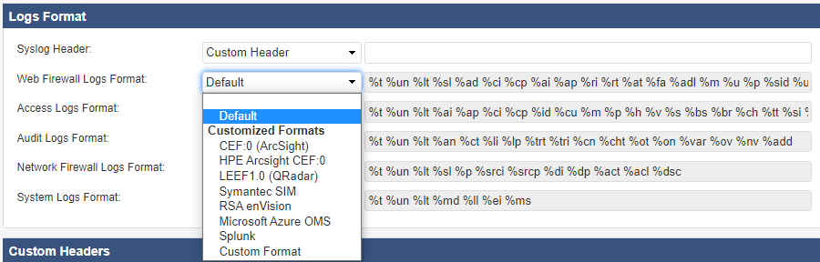

Running with Filebeat, the process opens up port 9503 as expected and I am getting logs. The problem is that they are not being parsed very well and no fields are being extracted.
In the WAF config, there are a few options for format to set the various log options to but I can't seem to get the logging to parse correctly. Filebeat README file suggests that the log format should be in the format of "RSA NetWitness log parser 2.0" but I can't find anything definitive to describe what that looks like.

For some context, screenshot below is from WAF settings which shows various options for logging customisation
