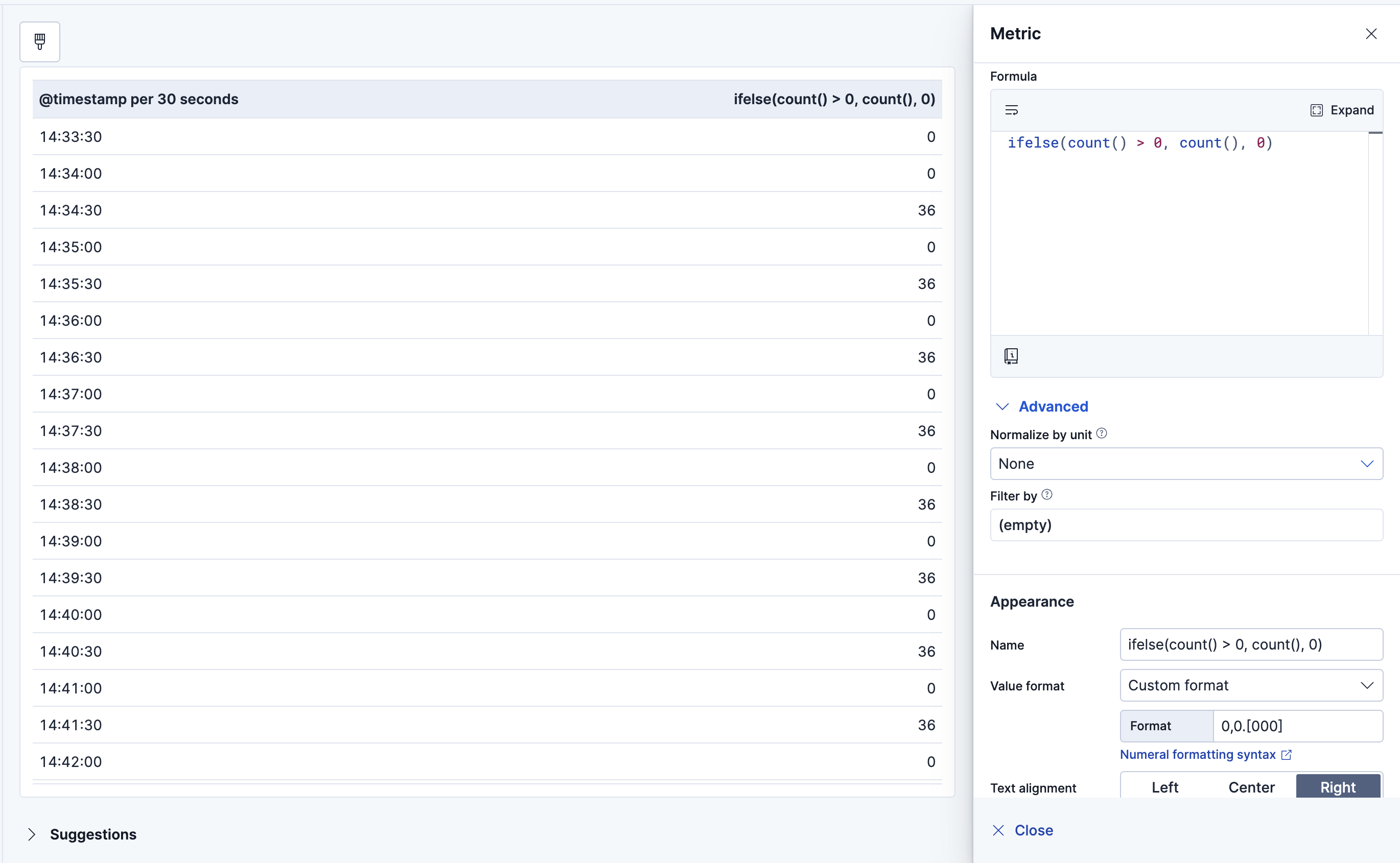

I'm not sure of a way to change it to a blank while keeping it numeric. You could make it 0 using the numeric formatting alongside an ifelse similar to the below:

count(), unique_count() and sum() should default to 0 when there’s no data (null).
For other functions there’s the default() which does when @carly.richmond is achieving with ifelse.
Unfortunately defaults() won’t work where there are no records at all, not sure it’s your case, but there’s an issue you can track about it here: [Kibana Lens] Possibility to display 0 or any other default value instead '-' in a cell when there's no record to display · Issue #205085 · elastic/kibana · GitHub

I'll see if the ifelse is sufficient and follow up on the open case you mentioned.
