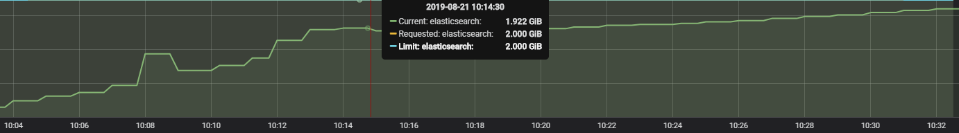

I think the RSS from the java process is not the problem.
But i don´t know why the node mem limit is reached.
memory.stats:
rss 1451929600
memory.usage_in_bytes:
2137989120 and growing
