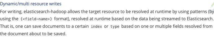

Found this at the Elasticsearch Hadoop Cascading documentation:
My requirement is exactly that, runtime resolution of index names and types. That is why I have implemented the Transport client to retrieve the index names and types and then used them in the cascading workflow to save data into HDFS.
