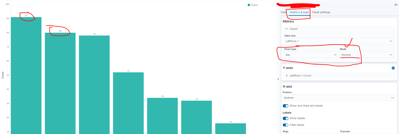

Pls check once the mode in bar chart column in metrics and Axes Tab.
If its stacked mode,values will be inside the bar.Please make it normal.I guess this will solve your issue.Do let me know your elasticsearch version.
Pic-Stacked Mode-
Pic Normal Mode-
unfortunately this doesn't work, as there is this option to place the bars on top of each other, and even with the "normal" option the number appears inside the bar, but thanks for trying to help
