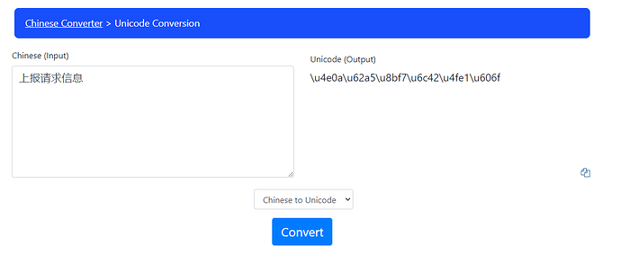

this maybe, Chinese Tool to Convert Unicode to Chinese
Hi legoguy1000,
so just only change chinese to unicode, right?
