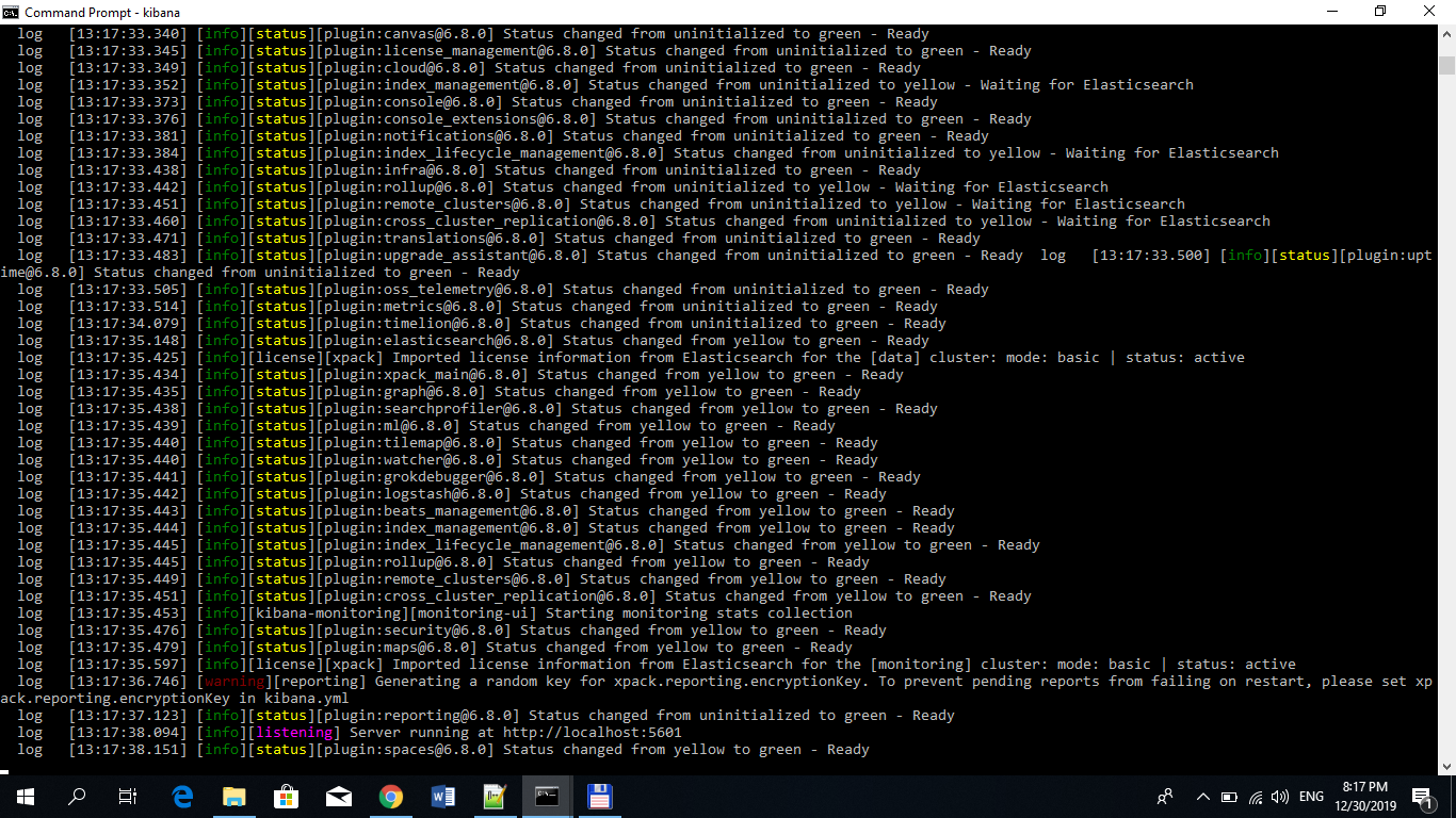

    below is my kibana console log

I got below error when I run yarn start
yarn run v1.21.1
$ sh ./bin/kibana --dev
'sh' is not recognized as an internal or external command,
operable program or batch file.
error Command failed with exit code 1.
info Visit https://yarnpkg.com/en/docs/cli/run for documentation about this command.
actually "yarn start" call kibana.bat, so I run kibana.bat
Could you try including the --dev flag? D:\ES\kibana\bin>kibana --dev
I got the same issues after run D:\ES\kibana\bin>kibana --dev
I see, this makes sense. In the CONTRIBUTING.md it says you have to use cygwin or another shell: https://github.com/elastic/kibana/blob/master/CONTRIBUTING.md#running-kibana
On Windows, you'll need to use Git Bash, Cygwin, or a similar shell that exposes the sh command. And to successfully build you'll need Cygwin optional packages zip, tar, and shasum.
Seems like it's not supported to start the development server with the default cmd utility on windows.
I got some errors related missing files, after I copied missing files to kibana\built_assets\css\plugins, It works
