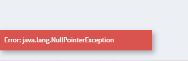

I can see below message at the bottom of the browser while trying to access Elasticsearch url.

My issue has been fixed. Actually we are using a load balancer and configuration was missing to access that Elasticsearch endpoint as defined in ECE.
Thanks All.
