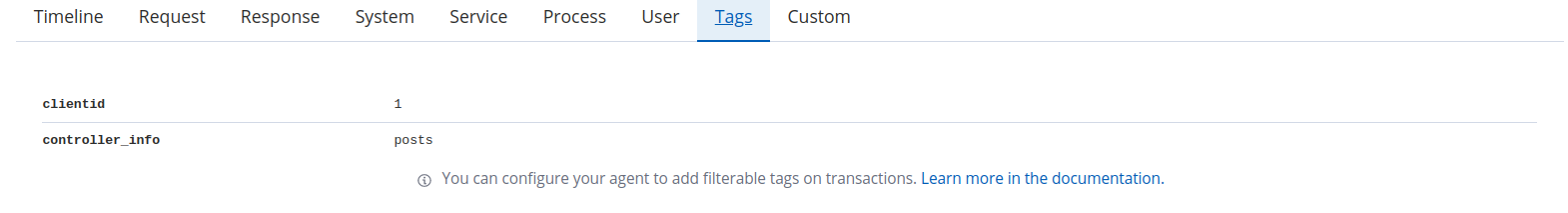

I have created the two custom labels in my posts_controller in my rails Application
ElasticAPM.set_label(:clientid,'1')
ElasticAPM.set_label(:controller_info, params['controller'])
I can only query the clientid and not controller_info :
Here is the screenshot of the above mentioned issue
Can able to query the context.tags.clientid
Can't able to query the context.tags.controller_info
But both the tags are available in the tags section

Hi Sudarshan013,
Can you please check what is the type returned by params['controller'])?
As in the documentation, it says the value can be string, nil, numeric or boolean.
