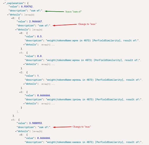

Tell me how I can change score mode from "sum of" to "max" on nGram field??
Due to the summation, the elasticsearch gives results that do not suit me. I need to get the maximum value, not the amount.

  "tokensName": "ирпень точный университет"
Search query:
  "size": 5,
  "query": {
    "match": {
      "tokensName": {
        "query": "ирпень фаворит ун точно",
        "analyzer": "standard",
        "fuzziness": "AUTO"
  "explain": true
Task solved: max_expansions = 1
