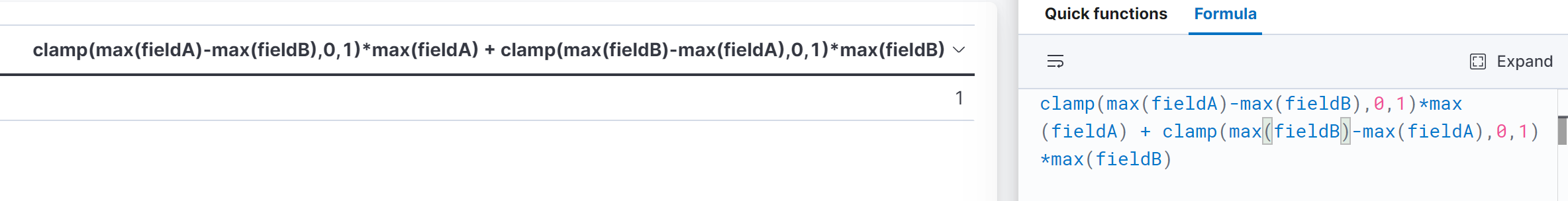

When max(fieldA)=4.8 and max(fieldB)=5 for example,
clamp(max(fieldA)-max(fieldB),0,1)*max(fieldA) + clamp(max(fieldB)-max(fieldA),0,1)*max(fieldB)
returns 0 + (5-4.8)*5 = 1. It must be 5.

Hi @Tomo_M
one simple trick would be to multiply the first argument of both clamp by an arbitrary big number you're sure it would make the difference > 1.
For instance in your example you could use 100:
clamp( 100 * (max(fieldA)-max(fieldB)) ,0,1)*max(fieldA) + clamp(100 * (max(fieldB)-max(fieldA)) ,0,1)*max(fieldB)
Using 100 even if the difference between the 2 max is 0.2, it will become 20, which will be converted by 1.
As I mention in the post, the clamp is a convenient "trick" rather than a final solution. :sweat_smile:
Thank you for a nice workaround! It may cover a lot more cases.
