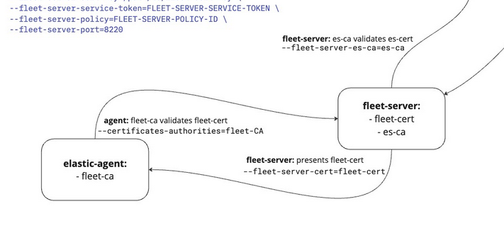

Actually, I think I have the wrong conceptual understanding of “what” is the fleet server. Even after reading: What is Fleet Server? | Elastic Docs and One-way and mutual TLS certifications flow | Elastic Docs , I think I’m not understanding something.
”Where” exactly is the fleet server being served from? Let’s say on the server 192.0.2.1, I run this command:
sudo ./elastic-agent install \
--url=https://192.0.2.1:8220 \
--fleet-server-es=https://192.0.2.0:9200 \
--fleet-server-policy=POLICY_ID \
--fleet-server-port=8220 \
--install-servers
In this situation, isn’t the fleet server and the elastic agent that made the fleet server the same thing, which is 192.0.2.1? And if so, then i don’t understand why tls certificate is needed to encrypt the traffic between two services on the same machine as shown in this diagram:
I know I’m misinterpreting the documentaiton or just have thing conceptually wrong in my head
Architecturally it's a subprocess of Elastic Agent, as listed in the What is Fleet Server? documentation.
Fleet Server is a subprocess that runs inside a deployed Elastic Agent. This means the deployment steps are similar to any Elastic Agent, except that you enroll the agent in a special Fleet Server policy. Typically—especially in large-scale deployments—this agent is dedicated to running Fleet Server as an Elastic Agent communication host and is not configured for data collection.
I may be wrong as I'm not a Fleet server expert, but given the documentation also refers to communication with Elasticsearch (see here) and the above auth options also refer to communication with Elasticsearch, it suggests to me that it's the Fleet -> Elasticsearch communication that the certificates are for:
  1. Fleet Server monitors Fleet indices, picks up the new agent policy from Elasticsearch, then ships the policy to all Elastic Agents enrolled in that policy. Fleet Server may also write updated policies to the Fleet index to manage coordination between agents.
Hope that makes sense!
