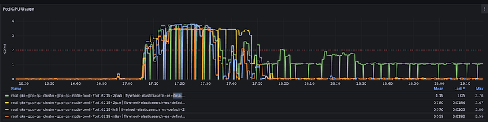

Constant read timeout errors while indexing; non-master nodes are idle; shard sizes are mismatched?
We are running an Elasticsearch 9.1.2 cluster with four nodes that is displaying some erratic behavior when under indexing load. Initially when we started indexing data, all four nodes (each a separate Kubernetes pod) were actively indexing. However, for the last hour-plus, only the master node (green line) is very active CPU-wise, while the non-master nodes are idle.
In the process that is trying to perform the indexing, I am seeing near-constant read timeout exceptions like this:

We are using version 9.1.0 of the python-elasticsearch client. Our code that is causing the indexing activity is mostly calls to helpers.streaming_bulk containing up to 300 indexing actions each.
Some other info about the cluster that might be helpful:
Cat nodes output:
ip         heap.percent ram.percent cpu load_1m load_5m load_15m node.role   master name
10.1.4.33            32          86  12    0.21    0.51     0.81 cdfhilmrstw -      flywheel-elasticsearch-es-default-1
10.1.20.71           56          90  37    1.64    1.54     1.55 cdfhilmrstw *      flywheel-elasticsearch-es-default-3
10.1.21.5            42          92  11    0.22    0.31     0.59 cdfhilmrstw -      flywheel-elasticsearch-es-default-0
10.1.2.109           60          97   6    0.32    0.29     0.25 cdfhilmrstw -      flywheel-elasticsearch-es-default-2
Cat shards output (why is one primary shard so much larger than the rest, when they all have about the same number of documents?):

Hot threads info:
::: {flywheel-elasticsearch-es-default-0}{mC6Ro8vATY2ZD9yrU0siRg}{o5B-wOyFSPWOMFREtEfQwQ}{flywheel-elasticsearch-es-default-0}{10.1.21.5}{10.1.21.5:9300}{cdfhilmrstw}{9.1.2}{8000099-9033000}{ml.allocated_processors_double=4.0, ml.machine_memory=12884901888, ml.config_version=12.0.0, ml.max_jvm_size=6442450944, ml.allocated_processors=4, xpack.installed=true, transform.config_version=10.0.0, k8s_node_name=gke-gcp-qa-cluster-gcp-qa-node-pool-7bd16219-n9sv}
   Hot threads at 2025-09-16T20:47:19.479Z, interval=500ms, busiestThreads=3, ignoreIdleThreads=true:
::: {flywheel-elasticsearch-es-default-1}{-HSrS5F_T_OxB7QG_OSNUA}{m1sxiKTsStu2cb9Dk2TxaQ}{flywheel-elasticsearch-es-default-1}{10.1.4.33}{10.1.4.33:9300}{cdfhilmrstw}{9.1.2}{8000099-9033000}{ml.allocated_processors=4, ml.max_jvm_size=6442450944, ml.config_version=12.0.0, ml.machine_memory=12884901888, ml.allocated_processors_double=4.0, transform.config_version=10.0.0, xpack.installed=true, k8s_node_name=gke-gcp-qa-cluster-gcp-qa-node-pool-7bd16219-2yce}
   Hot threads at 2025-09-16T20:47:19.480Z, interval=500ms, busiestThreads=3, ignoreIdleThreads=true:
   100.0% [cpu=0.0%, other=100.0%] (500ms out of 500ms) cpu usage by thread 'elasticsearch[readiness-service]'

::: {flywheel-elasticsearch-es-default-3}{DkwriEhsSHa91NYAm75lUg}{ekY7bC8uT9aHHcUtj717dA}{flywheel-elasticsearch-es-default-3}{10.1.20.71}{10.1.20.71:9300}{cdfhilmrstw}{9.1.2}{8000099-9033000}{ml.allocated_processors=4, ml.max_jvm_size=6442450944, ml.config_version=12.0.0, ml.machine_memory=12884901888, ml.allocated_processors_double=4.0, transform.config_version=10.0.0, xpack.installed=true, k8s_node_name=gke-gcp-qa-cluster-gcp-qa-node-pool-7bd16219-2pw9}
   100.3% [cpu=100.3%, other=0.0%] (501.4ms out of 500ms) cpu usage by thread 'elasticsearch[flywheel-elasticsearch-es-default-3][flush][T#17]'
     10/10 snapshots sharing following 40 elements

I have been seeing this issue for a long time and had hoped that upgrading to ES 9 would help alleviate it, but this seems to not be the case. Please let me know if I should provide any other info to help diagnose this. Thanks in advance!
