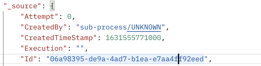

However, this is what I receive in Postman:
Where CreatedTimeStamp is now an Int (or Long).

Elasticsearch.Net.Utf8Json.JsonParsingException : expected:'String Begin Token', actual:'1631555771000', at offset:344
Basically, how can I convert the type from ES to fit the C#?
